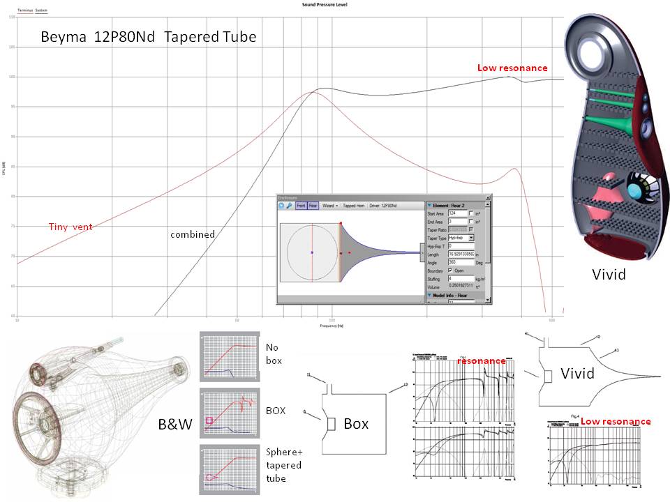

The Faital 12PR320 uses a triple roll cone surround which usually produces greater low level details than the double M-Roll used on the 12PR330. The 12PR320 has a slightly lower Le, Mms, and Fs which should make it a slightly better sealed volume midrange.... -F3 ~90Hz in a sealed 1.1cuft volume. A midrange box built with a large open volume behind the driver to allow explosive air movement, with a stuffed tapered rear volume behind to reduce resonances is used in high-end speakers.

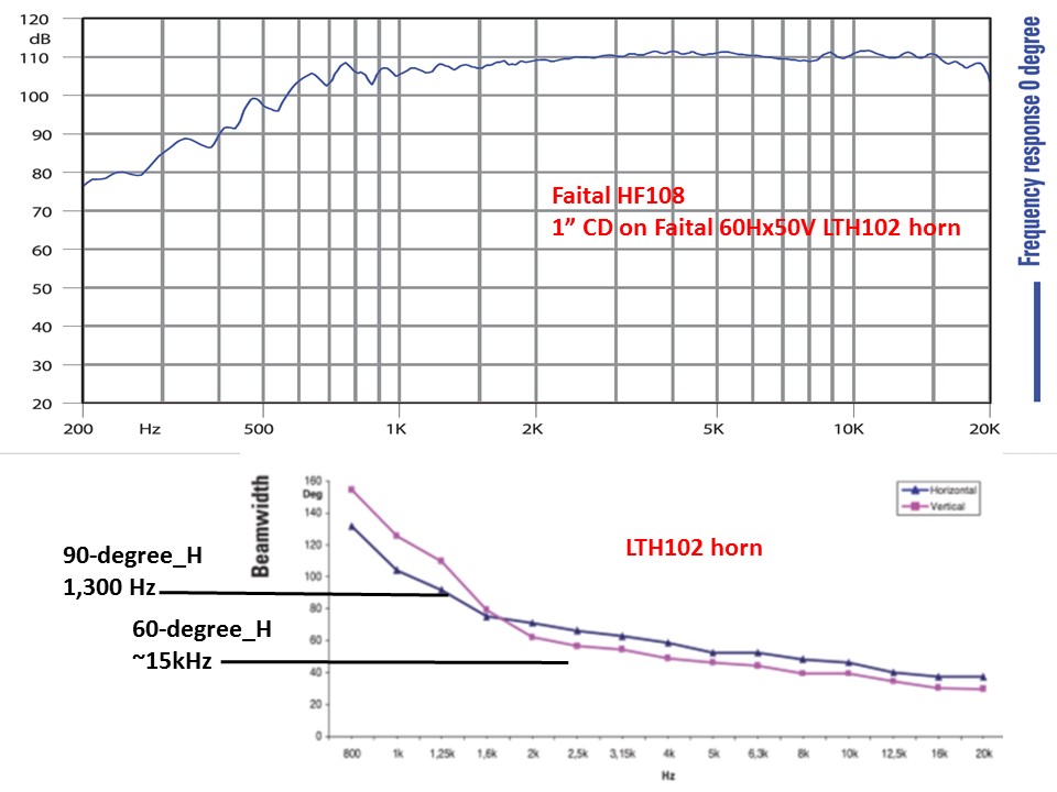

You want to select a tweeter horn/waveguide which has the same polar directivity as the 12" midbass at the crossover frequency. Good summary in Earl Geddes "Directivity in Loudspeaker Systems" paper

You can build an exceptional 3-way using either a 10" or 12" midbass. Most designers start with the room size, shape, and seating and select the best horn directivity pattern. In the USA it is easy to get 90H x 40V SEOS 12" & 15" waveguides, plus the B52/QTC horn. Fatial offers 60H x 50V LTH102 for greater pattern control.

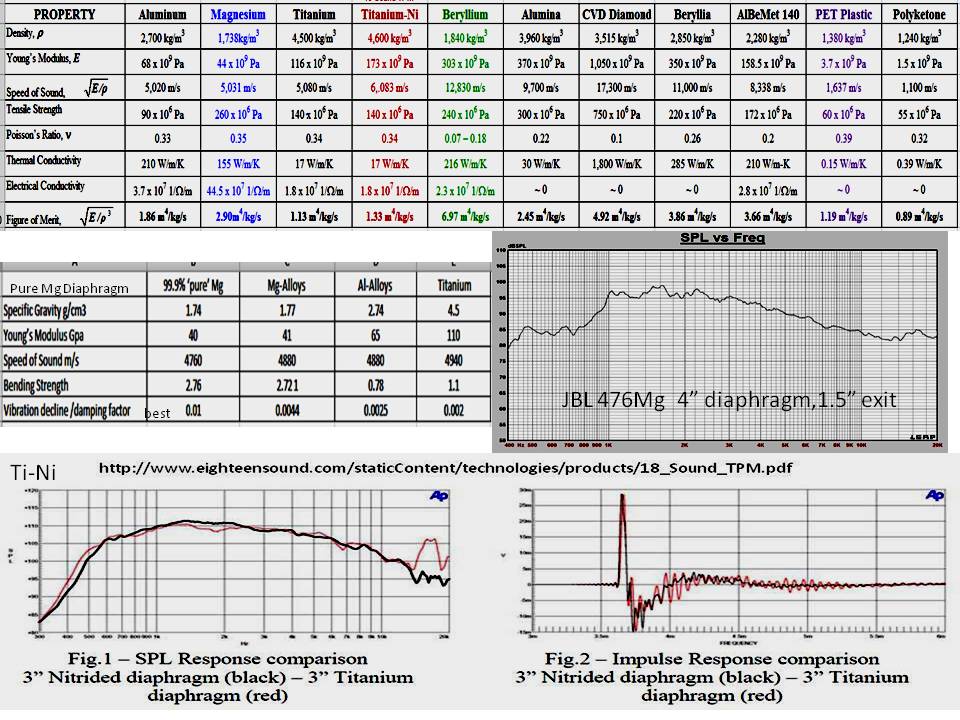

For "The Loudspeaker 1 and 2" Troels Gravensen selected the 18Sound NSD1095N HF Neodymium 1" Compression Driver because he favored the tone of the Titanium dome with a TiN coating. The NSD1095N specifies a crossover frequency >1,600Hz, which is best matched with a 10" midbass. Most 12" midbass favor a crossover ~1,100 - 1,300Hz and will beam and breakup at 1,600Hz.
Attached spec Faital HF108 compression driver on 60Hx50V Faital LTH102 horn crossed at 1,300Hz, showing starting ~90-degree room directivty and reaching 60-degreesH above 15kHz.

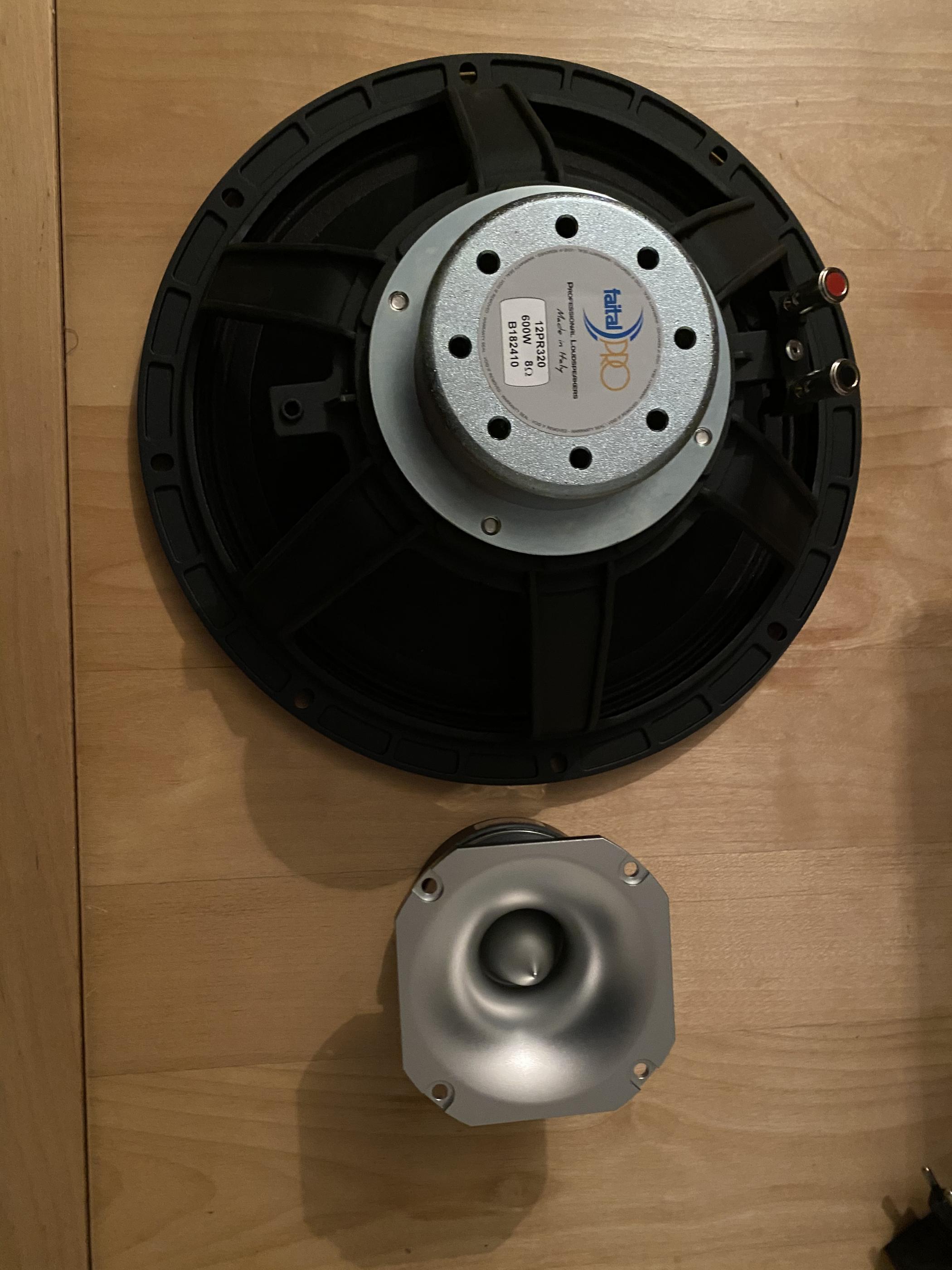

Thanks!! Then I'll use the pr320The 12PR320 has a slightly lower Le, Mms, and Fs which should make it a slightly better sealed volume midrange....
great! but i don't know how to calculate the box e and the vent, do you have a suggestion?A midrange box built with a large open volume behind the driver ...

so are you telling me that a 3 way system with faital hf108 1300-20000hz is better?Attached spec Faital HF108 compression driver on 60Hx50V Faital LTH102 horn crossed at 1,300Hz ....

the toys arrived, the birch plywood arrives in a few days, construction begins
