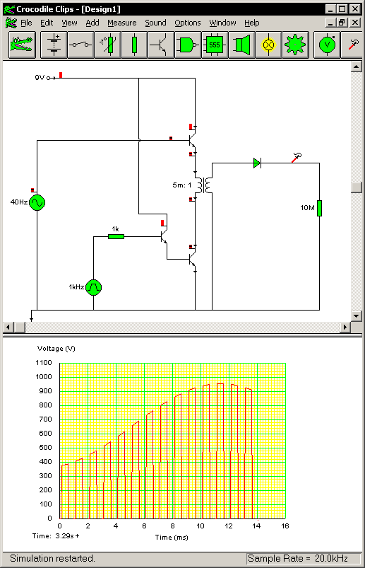

That IC looks cool, but I just realised I'm not entirely sure what doing PWM onto a transformer will achieve - you're just putting the same signal onto the primary, but with some high frequency artefacts. I get the feeling I'm missing something, are you supposed to put PWM on the primary but as a single ended signal and rectify the output of the secondary, a bit like how an AM radio works?
I came up with a circuit to create the high voltage signal. Obviously it would need a lot of changes to work in real life (and probably use mosfets), if it would even work at all. The similator I used is horrible 🙂
Ok yeah basically you can use PWM but you have to rectify it and the max voltage is a square wave and lower is shorter pulses (Also, the design I posted above is inefficient and pointless) (thanks to el`Ol for this info in the other thread 😀)
You can't just apply a pwm signal to a tv transformer, the audio frequencies will probably saturate the core or at least heavily load the amplifier.
If you apply only half the pwm signal to the transformer and let the transformer get rid of it's energy during the other half then saturation won't happen, if I'm correct.
Bigwill your schematic is actually amplitude modulation but will probably also work.
