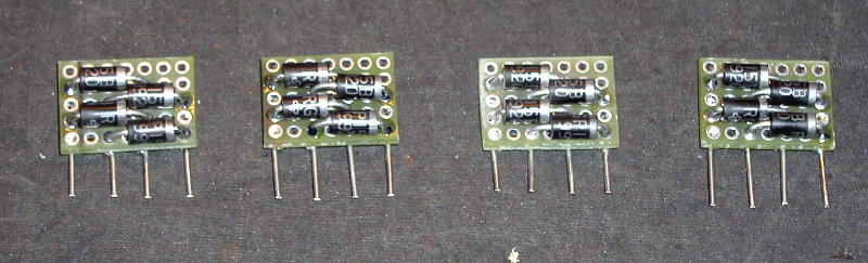

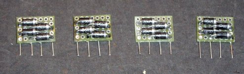

No, I actually mean redesigning completely PS and output stage, as well tuning the DAC auxilary components.

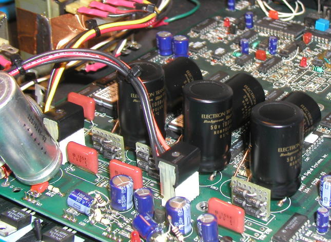

Tonight I did the first step into modding and changed the rectifiers,as well removed all those ceramic bypasses (on bridges).
And I already begin to like the DAC: the sound gained immediacy and is more open.
I used RGP 15B I was using previously with good results in a transport.

Not a fan of FREDs? I like your daughterboard implementation.
Any idea why Meitner put those little antenna posts on leg 1 (?) of some of the ICs?
They more I peruse the guts of the BIDAT, the more impressed I am with Meitner's engineering.
-Rob

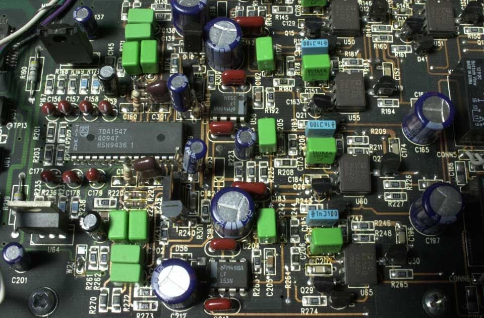

ash_dac said:
Is the BIDAT a dual differential tda1547 design ?
Just one 1547, see pic...
The implementation of DAC section in Bidat more or less follows the TDA1547 datasheet: http://www.semiconductors.philips.com/acrobat_download/datasheets/TDA1547_CNV_2.pdf
Are you going to replace the LF353 ?
Not sure which Analogue Devices chip is the enhanced replacement for LF353.

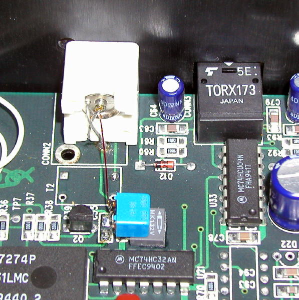

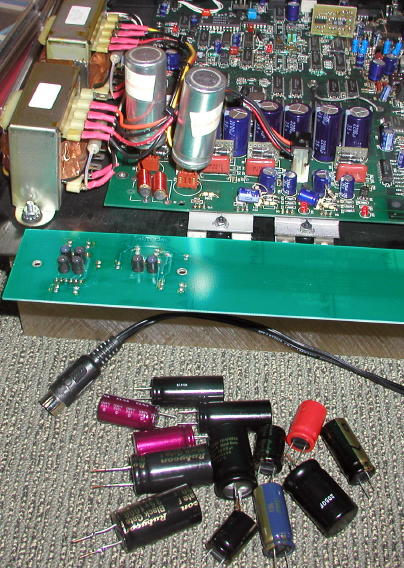

I spent whole day yesterday modifying the board. In terms of transparency and immediacy the biggest improvement was brought by changing rectifiers and removing input transformer on SPDIF input. Before any mods, I much preferred Apogee Wyde Eye interconnect, after the mods, Kimber Illuminations D-60 is much better.
In the input section, the digital signal goes through crappy RCA, coupling transformer, SMD cap and resistor.
Changing for BNC jack didn't bring much difference. I used 75 ohm type, D-K part# A24602. I didn't drill holes to mount it on the board (4 layer board), but simply attached connector to the board with double sided tape. Please note that the original RCA has center pin connected to the shell, not input. Also, the ground from the RCA connect through 100R resistor to circuit ground.
My mods included removing completely the transformer, installing Vishay/ROE coupling cap (IMO best copuling cap for digital applications), terminating input with 75R Caddock MK132 resistor and connecting BNC ground directly to circuit ground. The DAC won't lock without coupling cap (even with my transport having output transformer installed).
This is very important mod and highly recommended. The hole in rear panel needs to be enlarged to 1/2"

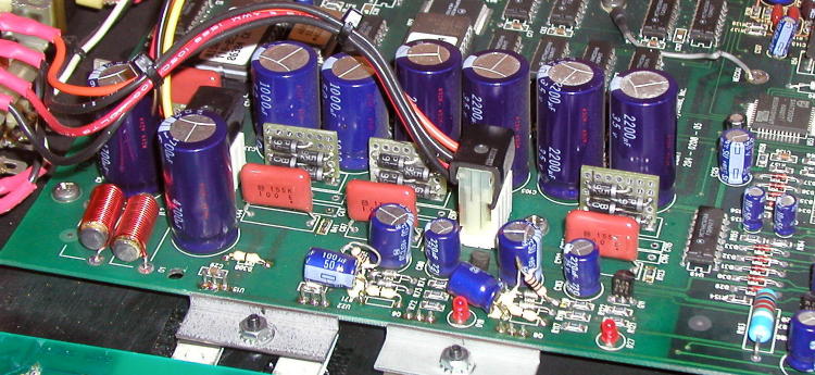

All main caps in PS filtering are in CRC configuration, in pairs with 5R resistor in between.
I started swapping caps with 4700uF in 5V supply. It was not easy to pick up the right sounding ones, nothing really blended well (including 1000uf BG N) , eventually I settled on 2200/16 Sprague Extralytics. While I didn't like those caps in some other applications, here they seemed better then all the rest (BTW Nichicon KZ simply sucked here). Those are quite large caps and it's not easy to find a space for them. One is mounted permanently, the other not, as I still need an access to regulator circuits for further mods. As usually, I don't have problem with installing much smaller caps than originally.
There are 3 more cap pairs on main filtering, and here nothing was really good, except for BG N 1000/50. Those caps are pretty expensive, at $60/pc, but working on greatest DAC of all times cannot be budget limited, if you know what I mean 😉
BTW, the differences with those caps are not really day and night, but more of a finer refinement type. With lesser quality caps , you may get more coloration, less satisfying tonal balance, more or less brightness, and overall less musicality. While BG N seem to soften sound a bit, they also have tendency to present the music in very natural way, they actually much less colored than other caps I tried so far.
It was also pretty easy to implement them here.
