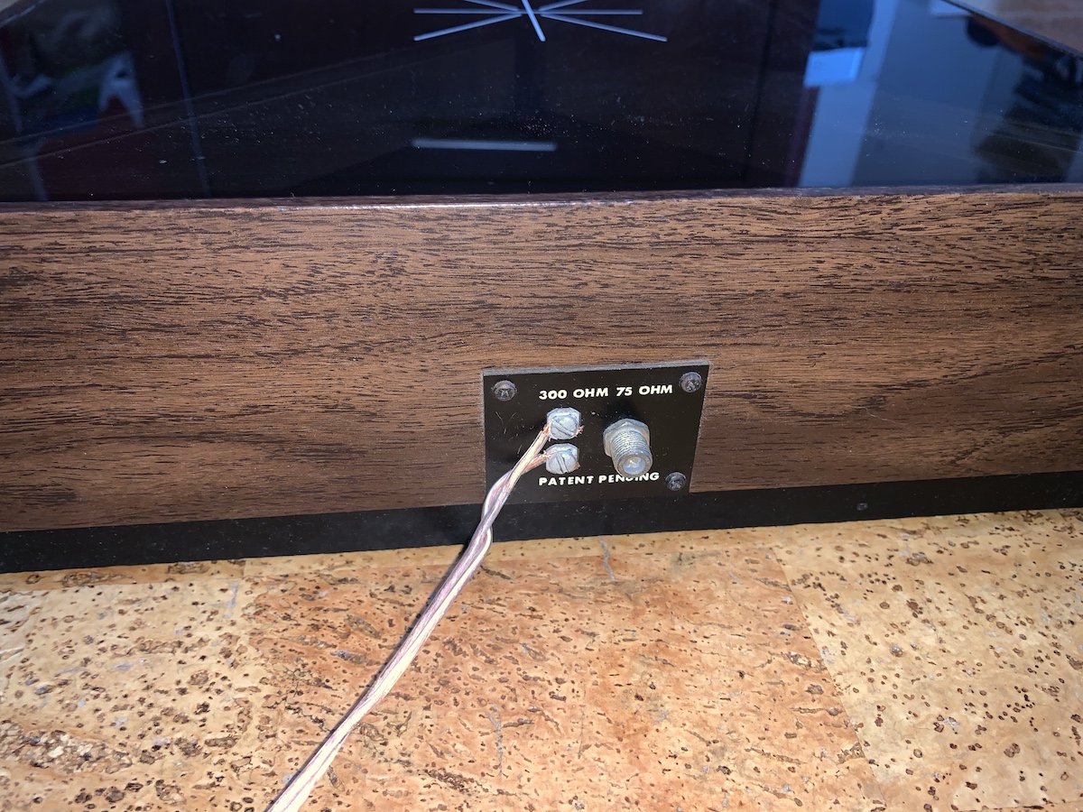

I have one of these for sale if anyone is interested. It is in very good condition! The only issue is the previous owner super glued the beam direction knob back on and it does not turn now. A little acetone and patience and it would be like new. PM me if interested.
