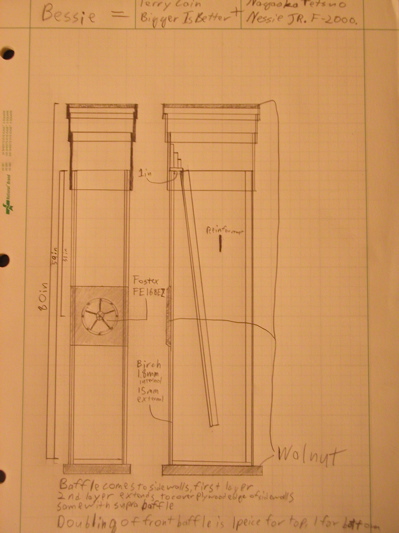

well, have a lookey here at a design I am dreaming up for the 168EZ. can't post a picture any bigger so use your imagination.

Nice one Clark. Be interesting to see what the modelled response will be like. I'll have to try later.
