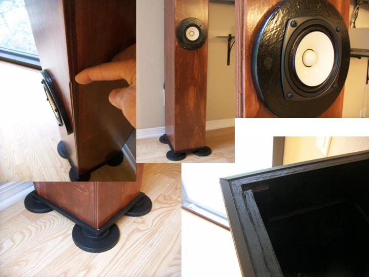

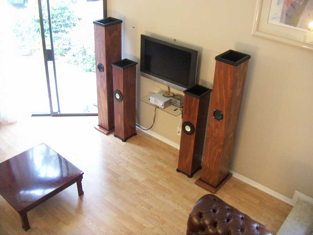

I think on my next enclosure for the DX-3's I'll mock something up in OSB first and then if they sound good I'll make some nice ones.
I'm leaning toward using 1.25" birch ply and then veneering them with something sharp like figured cherry or quartered white oak.

I'm envious of your cabinets. I could veneer mine, but I know they'd be kind of ugly. I suppose you can't learn to do it well without first trying, but when they're the biggest things in your living room, you hate to do 'em ugly.
I bet the OSB will have some resonances and flex, but it will definitely let you know whether you are getting the bass you are after. Make sure you either use the recommended series resistor size, or order some plenum grade Cat5 (I'd get Belden) of the appropriate length. (One run will do, as you get four twisted pairs from each run, and you only need one per side.)

"OSB" definitely not the best material that's for sure. But I can get 3/4" 4x8's really cheap.
As for the veneering, it's really not very hard. There's one or two techniques that one needs to understand but after that it's no deal. Traditionally veneer was adhered with hide glue and that's a difficult way to do it. Mills that produce veneered sheet stock usually use pva and then hot press it. Obviously the average diy guy isn't going to do that. But some of the modern contact adhesives work great and are fairly easy to use. Maybe I could write a tutorial so the average garage warrior could both build his boxes well, but also veneer them for a better appearance.
