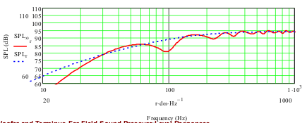

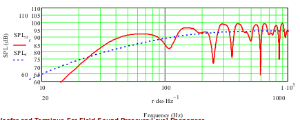

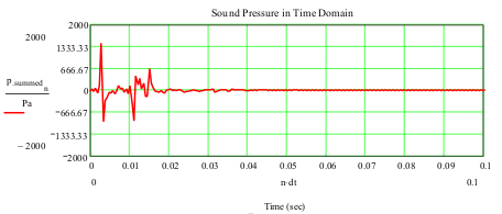

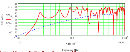

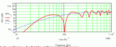

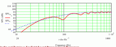

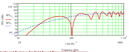

BIB with 167E, open top exposed
stuffing.
I think they need some stuffing. the places most people say. a little in the bottom, a little behind the driver. I was getting a 400hz resonance in my pair. stuffing killed the bump and helped the sound presentation somewhat. the 167e is a damped sounding driver, so it needs a damped enclosure to some degree perhaps.
the least stuffing you can get away with is generally better.
