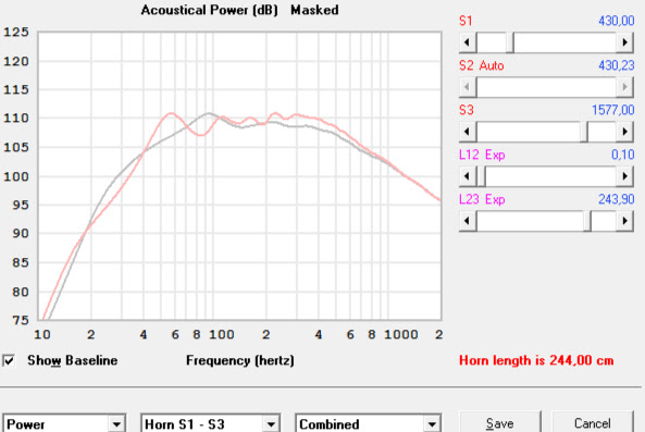

Here's my design. Clearly inspired by, but not quite a BiB.
The sim shows the Olson horn in red and my take in grey. The response of my hybrid thing evens out nicely with 12dB/octave room gain. Turned out that room gain was 18dB/octave but no worries. Just extra headroom in case of easy DSP.
Definitely not a BIB as they're usually described, i.e. a tapped pipe horn with zero throat area for maximum gain BW, tuned to 1/2 wavelength of the target frequency. I can't see anything particularly 'hybrid' about the box you indicate though; it appears to be a conventional enough tapped pipe horn (aka Voigt pipe / horn, TQWT etc.)
I can't comment about the comparison since I've no idea what box you refer to as 'the Olson horn' was. Either way, you've clearly selected the option that works best for you in FR terms for the given acoustic space you have.

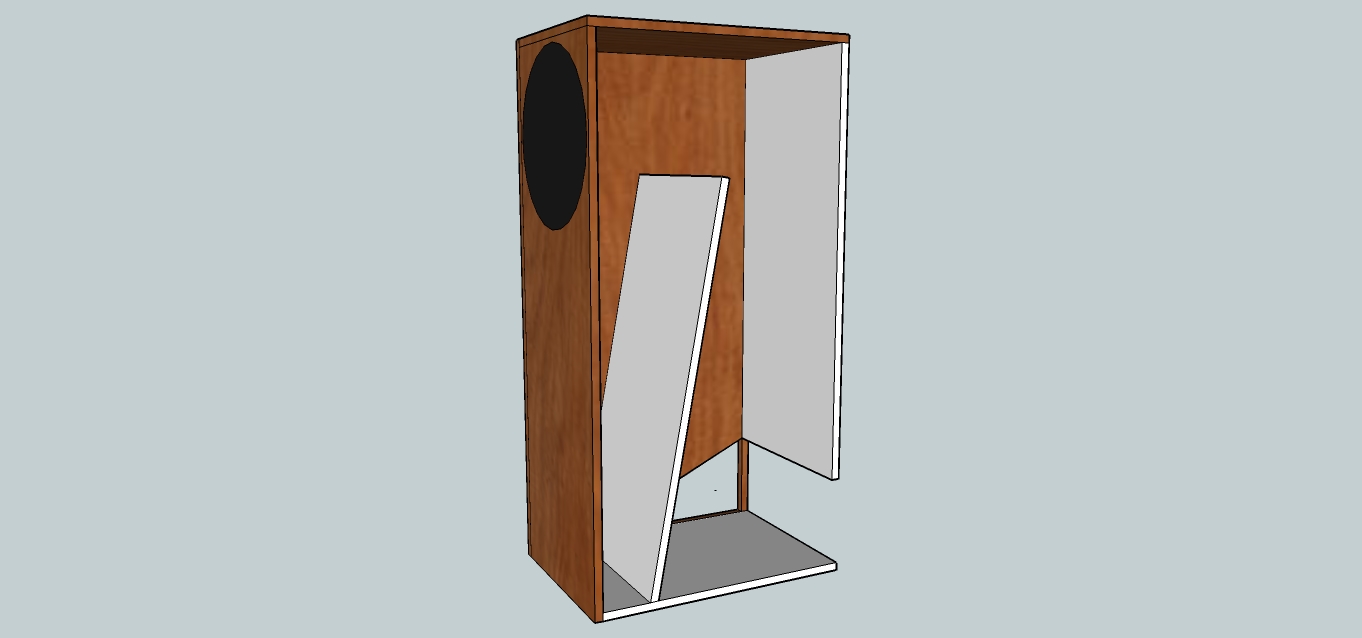

Net up is a version of the Voigt Home Constructors corner horn. Haven't quite figured out how to angle the curves in the side walls. I hear that's a common issue... ;-)
That it is. Getting angles right is usually a pain with designs of that type. Good luck!
Are you using the LC-1A? If you aren't, you weren't loading the Olson design as intended so the response may have more deviation. Although I can't quite tell if what you built was inspired by it rather than that box per se. BTW, the folded horn indicated in the build diagrams is not actually an example of manifold (sometimes called Olson / Nagaoka) construction, which is a separate approach used in some of Olson's Studio designs, and employs in at least part of the overall design an expanding cascade of individually untapered manifolds.

I know it's not the classic manifold design. Someone mentioned it reaches low and does it well witha fullrange driver and it caught my attention. ;-)
I simmed with my Fane Souvereign 15-300TC. It matches certain traits of response measurements that were floating around the web at the time (made by whatshisname of the cast iron conical horns). GM also noted the driver sims well in other enclosure designs made for, or used successfully with, the RCA driver.
