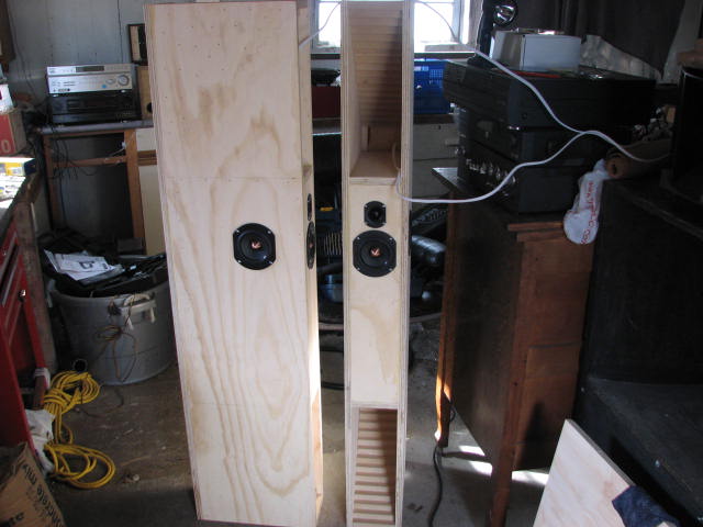

Is it feasible to resize the (side-firing) Calhoun box to utilise the above drivers?
Shadow was designed for 2 Extremis, SDX7 should work. I may even have a revised variation in the queue for an SDX7 specific one.
dave
Cal Weldon said:Scottmoose will have to help with that one. The Calhoun is a simple box so I'm wondering if the line is long enough ie: the line before it enters the horn. Maybe a new design in the works?

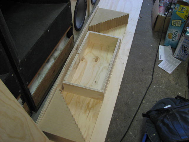

That picture you posted illustrates just how much timber goes into making those stepped vents.
Suggestion #1
Use an angled piece of ply with strips of 45 degree triangular moulding glued across it; or
Suggestion #2
Use a double thickness of ply angled, but with 90 degree "V" trenches routed (routered?) across it.
Either way, fewer trees die!
cheers
Doug
PS Perhaps the best option is to stack to make the lower vent, and make the upper one using the suggestions above - lowering the C-of-G and making the box that much more stable.

Originally posted by Brisso57
Cal,
Yes but I thought it an excellent use for an old piece of that nasty stuff.
Suggestion #1
Sounds like a lot of work considering it probably sounds ok as a flat piece.
Suggestion #2
Jiminy crickets man. I'm thinking the stepped pieces add more character than anything that can't be looked after with some well placed stuffing in the horn throats. They're the only plywood boxes allowed inside, there's a kind of neat factor.
cheers
Doug
Cheers Doug
That's true, it's just that mdf is not my friend and I thought that's exactly what I would want to use it for.
Now we're talking.
