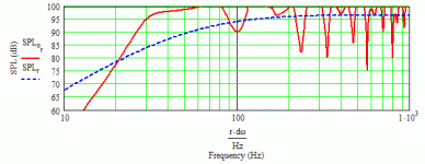

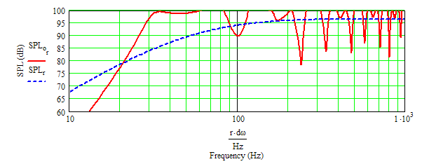

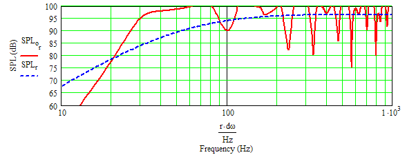

They would get used in a 9x12 room. They would be corners. Being that its a small room I'm not sure how well they would work. Might have to stuff the whole lenght. lol. I changed the Vas from 2.92 to 2.0. It changed the dims to 67.5 x 23.5 x 16.5. Whats going to happen?
Hmm, I'm in a ~12 x 13 ft room and I'm thinking that corner loading these might be a bit much in mine, so going a little taller using T.C.'s 138" path-length and reducing Sl to ~398.9" might be a better fit.
