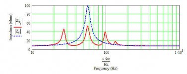

Wish I could find drivers like that! I'm afraid completely shot for time at the moment -got another paper to prepare & then I'm back down to Cornwall tomorrow until Tuesday, so I can't do anything refined -sorry. However, if you want me to SWAG it, then I'd go with a 138in line, Zdriver of 30in a la TC's original, and Sl=150in^2. Should do the job pretty well.
Scottmoose said:........then I'd go with a 138in line, Zdriver of 30in a la TC's original, and Sl=150in^2.
Greets!
FWIW, I'd bump up 'Sl' to 220"^2, so ~12.43" w x 17.69" d.

GM & Scottmoose.. Do you have a formula so i can recalculate "Zdriver" ?
I tryed recalculating the Line length, 34300cmsek / 47hz / 2 /2,54" = 143.65" this is a little bit taller than the 138" suggested, will this make any difference to the suggested SI (12.43" w x 17.69" d) Or should i just keep the original 138"Line Length/30" Zdriver ?

A simple formula doesn't take into consideration the terminus' (Sl) end correction, so assuming the WS's SoS = 34,200 cm/sec and 57 Hz Fs, the impedance plot indicates it's the correct length.
That said, if you want to increase the length, then maintain Sl's dims and add 1/2 the difference to 30" to maintain the same driver/floor height.
GM

Thank you for your support... what frequency should i use for calculating the Line Lenght ? Original datasheet has very limited data on frequency, "min. resonance frequency = 40hz" and "Qo = 0.5 at 40hz", also found some other specification at http://www.spectrumaudio.de/breit/vintage.html that says "Fres 57Hz". I'm a bit confused
