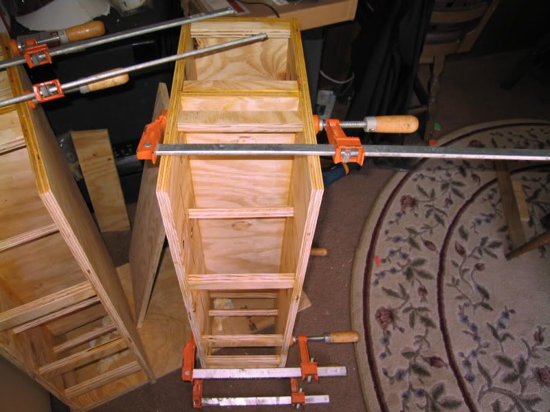

Bofu TL bracing
I like to use dowels to cross-couple panels. Here the "Dowels" are just strips of ply, but they do the job. Nice thing too is that they act as dispersion devices for HF in the line (this is the Pass TL for the BOFU). I also doubled up the thickness on the driver mounting baffle, and laminated 1/4" premium ply over the lower quality ply used for the majority of the construction. You can see that the "dowels" couple to the front panel as well, so that's got "ribs" in effect.

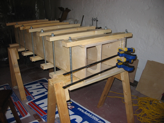

I used a bunch of 2x4s and 5/8" threaded rod. Not quite as user friendly as proper clamps, but they sure don't break the bank. I even moved those "clamps" and use them to this day. I wouldn't trade my pair of quick clamps for anything, but I've managed to get by with a pair of them, a pair of ultra cheapies and the 2x4s.
