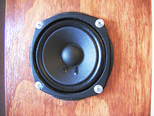

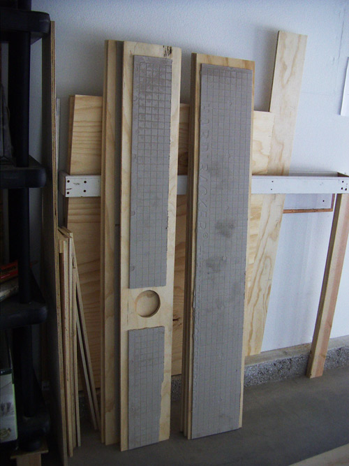

Godzilla said:I have a couple of comments. Firstly, great job!
Which dims did you use?
Godzilla
I used the Scottmoose's suggestion, from his original quote.
"El Cheapo speaker BIB demension: (Scottmoose)
Try a 120in line length, driver at 24in down from the sealed end, 70in^2 terminus area. Inside demensions: 7x10, height:60, speaker placement: 24” from top to middle of the speaker, inside slanting baffle ends 5” from the floor and 5” from front and 5” from back."
I used the hardibacker (1/4" cement board to stiffen 1/2" plywood).

I was going to change the speakers to more main stream (e.i. more expensive) but my wife says how can they sound any better?? I admit I may not have the golden ear of the audiophile, but I listened to many speakers (had electrostatics magnaplanar etc), and these actually sound real good... so for now I will just enjoy these pups.

I live near u in Irvine, know San Diego well. You should try the el cheapo in BIB, just amazzzing. I was actually building these as a trial for FE167 in BIB, but turned out too good.
Now I may get the same el cheapo and try it in another cabinet, but so far I am totally sold in BIB format.
