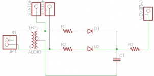

It does look like a nifty way of doing it but To be honest, the Koss patent is the best way I can see if a self supplying design is required. For a battery powered version, the joule thief may be worthwhile.
