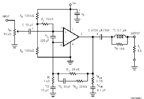

carlosfm said:You can't use an op-amp with single voltage as you use with +/- rails.
Of course you can (for most amps). People usually float the ground to 1/2 of rail, and use a cap on the output to block the DC offset (not at 1/2 of rail).
it has been done many many many million times over, 🙂

I know.
But try to use a virtual ground with two resistors on a power op-amp.
You have to reference a mid-point between + and ground on the input.
That's what those two 100k resistors are doing there.
And that's what we can call a single supply implementation.
With a virtual ground it's not a single supply anymore.
Yes.millwood said:
so you can or cannot use opamp with a single supply?
I never said you can't.
I just said that the implementation is different.
You can't just throw V+ and Ground to most op-amps and expect them to work.
Those two 100k RA resistors have to be there.
With double supplies you don't need them.
Neither the output cap.
Compare the normal implementation with the single voltage, on the LM3875 datasheet. It's a good example.
With large currents (like with power op-amps) the PSU voltage will get unbalanced (-1v, Ground, +25v).millwood said:
what problems would we encounter?
You may use two resistors to make a virtual (PSU) ground with signal op-amps.

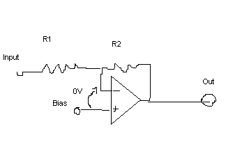

By inserting DC in the signal, don't we get off the switching in the B stage.
And didnt I insert the dc Before the B stage?
Of course, I could be wrong...
Sorry, you are wrong. The biasing has to do with current, not voltage. The NPN device (on the + rail) will be conducting when current needs to flow out of the output pin; the PNP device (on the - rail) will conduct when current needs to flow into the output pin. For the case of a simple resistive load, if there is always a +ve DC voltage on the ouput, then there is always current flowing out of the output pin, and of course, the NPN device will always conduct, so the opamp will essentially be operating in class A. However, real world loads are not purely resistive. The current through a reactive load does not depend purely on voltage, so maintaining a positive voltage does not guarantee a positive current. Also, in the real world, we cannot have that huge DC offset. And placing a DC-blocking capacitor in there will block the DC current, defeating the purpose (no more class A).
The best way to bias an op-amp into class A is to put a current source to -ve rail so that current always flows out of the output pin. This forces the NPN device to always conduct and the PNP device to never conduct. Take a look at Linear's LT1115 datasheet. They use a current source (a FET and resistor) to the -ve rail in many of the example circuits, although they don't actually mention why.

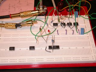

hi guys,
i tested an opa2132 with bias currents from 0.4 to 8mA and to tell you the truth i don't think i can really hear any difference. As it's a battery powered headphone amplifier i'll just leave it in class ab. disdtortion is very low with this chip (0.00008 or something) anyways,
It might be my somewhat cheap sennheiser hd477's.
I hooked it up to my gainclone and guess what, it sounded pretty good (although gain was far too high), a lot more control in lower freq's. Soundstaging is also better.
So, my next project is an opamp based pre for my gainclone. Maybe i'll give class a biasing another shot there (although the opa627's have an even lower distortion figure).
Viva the opamp! (don't shoot me for saying this!)
