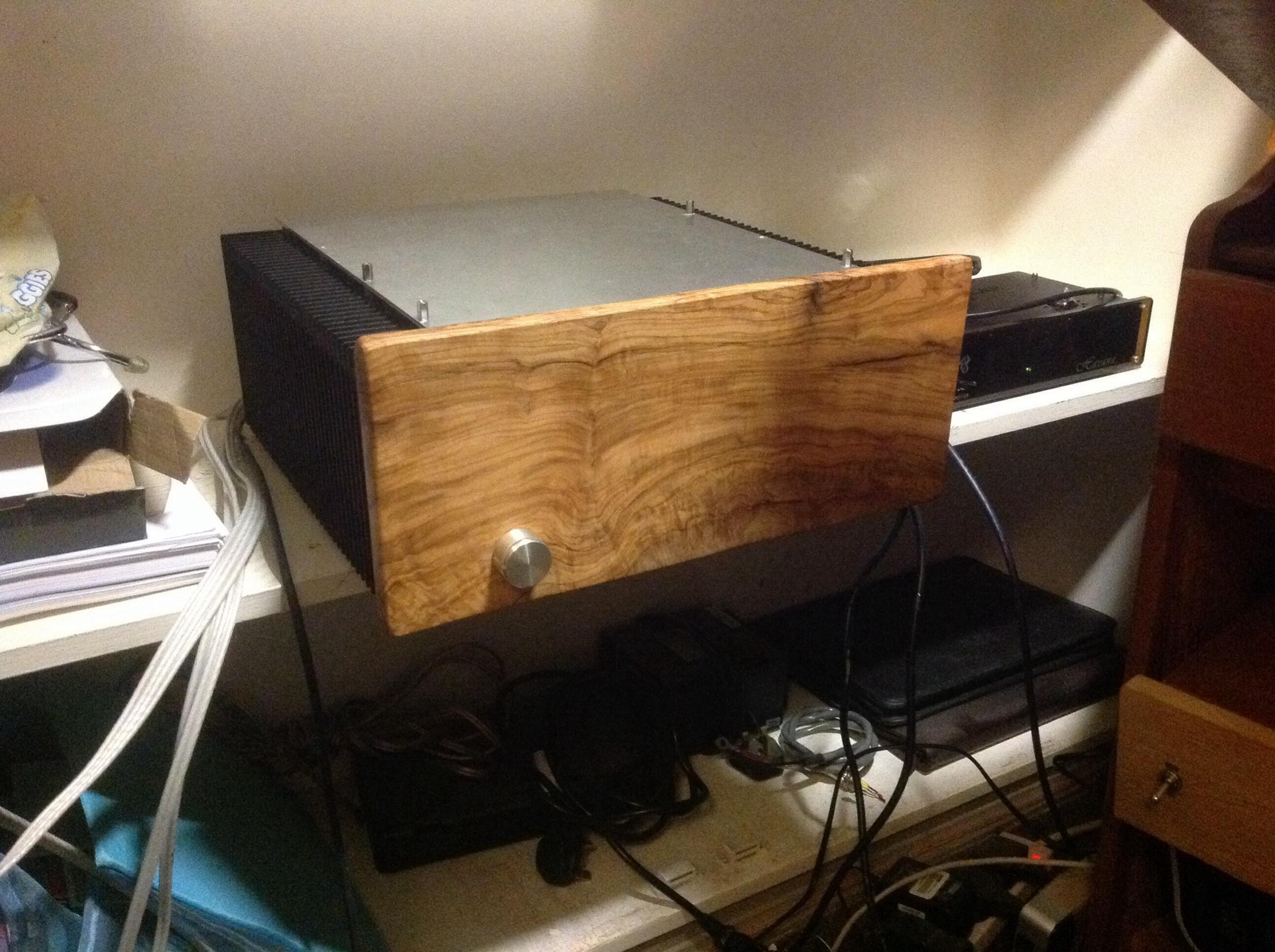

That's a nice look with the wood front panel, also it won't heat up from being in contact with the heat sinks. I may try this concept for my "Vanilla" amp when I finally get it running (perhaps this weekend). I'll start out with FR-4 panels, but will maybe switch to wood once things have been running for a while.
The front panel is an olive wood chopping board. It sits on a plate of aluminum, held away from an identical plate (screwed to the heat sinks) by 5mm spacers.
Top and bottom plates also sit off the heat sinks via 5mm spacers, no need for mesh and it runs on the cool side for its spec.

Have to say, now I've got fully functioning boards, my jaw is on the floor at how awesome this amp actually is.As tempting as it is to wax lyrical, I know I will be preaching to the converted!
