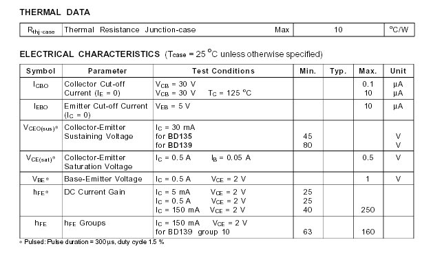

We all know that it is important to bias a transistor and it's some where near a mid point. But the question is in the data sheet, what is it we look for that determines how do we select the resistor to bias the transistor with real like transistors??? Take for example a PNP transistor BD140 or a NPN transistor BD 139. Also how do you know the Beta of the transistor from a data sheet.

I'm familiar with calculating from a diagram but i'm not really familiar when reading from a data sheet. For example from the data sheet given, the hfe or beta is 250 if i were to send a current of 150mv to collector. Thus using Ic/hfe=Ib, then to get hfe 250 i got to send a current of 0.6mA to the base to get 250 gain is that correct???
Morello, thanks for you advice. What then would you rely on if you were not to design a circuit from it's hfe. care to share some insight with a newbie??

Try to make the circuit rely on the values of passive parts such as resistors etc. If your bipolar device has a typicla current gain of 200. Contemplate what happens if it reduces to 100 or increased to 200. The manufacturing spread with respect to current gain is large.
Transconuctance in bipolar devices are a rather good parameter to rely on.

With bipolars the parameters vary alot from one device to the next, even though they have the same part number. A side-effect of making small things in silicon. So in the datasheet the beta is shown to vary from 25 to 250 depending upon device and operating point (a factor of 10!).
Other parameters vary too: Rpi, Cbe, Ccb, Cce, Ft. In the case of beta and Rpi and Ccb - these are most influenced by Ice and temperature. Ccb is most influenced by Vcb. If Vce drops much below a volt the transistor parameters start changing rapidly.
Morello is right to advise designing a circuit to be tolerant of beta variations, unless you are hand-picking the part and keeping its temperature steady during operation.
The small-signal transconductance is the Ice/Vbe and usually follows the Ice/25 rule closely for small-signal devices. Eg: the differential transconductance of a long-tailed pair is calculated from the gm of the two transistors.

Thnkas for the insight on beta. But beta affects the close loop gain, the open loop gains and the unloaded differential right. But how does one find all these value??? are they in the data sheet as well??
You can find beta(current gain) fram data sheets.
The gain in i particular gainstage depends on how you implement the transistor.
The voltage gain in a diff-pair(long tailed pair) os approximately:
Gain=Rc/( 2*Re + 2/gm)
Rc=collecor load
Re=emitter degeneration resistors
gm=transconductance=Icq/25
Icq=quicent current measured in milliamps
