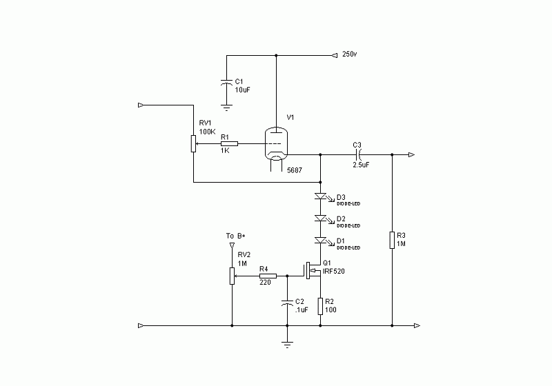

And don't forget a gate stopper resistor, 220 ohms or so, attached physically right at the gate.
That said, this is still a much more complicated circuit than you need.
Put the 220 ohm resistor directly to the gate. The bypass cap goes to the other side of it. The grid resistance (pot in this case) ties back to the FET drain, not the top of the LED string. Cross your fingers that the biasing gives you the proper current.
Regulation is probably not important- this is a class A circuit. But the rails should be reasonably quiet, and that means thorough bypassing.
A much simpler solution is using a negative rail for the cathode return as I mentioned before, losing the current source.
I'm afraid that's not going to work.
Your volume control pot must go down to ground. As you have it, not only would it pass DC onto all your sources, but it would be unable to attenuate.

It would be even better if the range of voltages to the gate of the FET was restricted to a maximum of +5V (4V usually turns on an enhancement FET). Replace the 1M pot with a 10k pot and take a 390k resistor up to the +250V. Then add a 1M series resistor between the pot's wiper and the 1k gate stopper resistor.
Alternatively, you could use a 9V lithium battery on the gate and fit a 500 Ohm variable resistor in the source circuit of the FET instead of the fixed 100 Ohm. The battery would not need a switch.

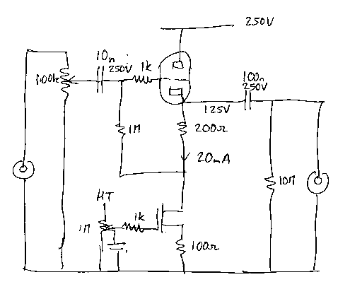

Why go trough all the trouble? Why dont simply use a ordinary resitance coupled follower with say 100V cathode and ground.
Just replace the CCS in the circuit posted earlier with a resistor of 5kohm, (if you want to keep current at 20mA). So then the circuit will be 5kohm and 200ohm resistors in series from ground, the gridresistor connected to the connection point between the resistors, (just replace the CCS in the circuit previously posted by EC8010)
The performance difference between this simple circuit and a CCS based circuit is not possible to notice as long as the output voltage is reasonable, only for very high voltage swing you can see any differences, an added advantage is that you dont need to contaminate the tube circuit with SS circuitry and the circuit will be very simple.
I have built and measured CF's using this method and CCS using SS or tube circuits and it is actually very difficult to measure any differences. However the diffrence between a CF using only the cathode bias resistor as the one you posted in your first post and a dual resistor or CF based on is stunning.

Let me put it this way. All the buffer needs to do is sound better than a Parasound PHP 850 which is based on opamps. If the standard output of a CD player is 2v peak to peak and the grid is biased at -6 volts, which in turn means the cathode ia at +6 volts, then there should never be any negative clipping. Right?
All it has to do...
The standard output of a CD player is 2VRMS which is 5.6Vpk-pk.
If you bias the cathode to +125V with a resistor, it will be pretty linear. If you bias it to +125V with a CCS load, it will be very linear. If you bias it to +6V with a CCS (and ground the grid) it might just be able to swing 2VRMS cleanly (the CCS uses up swing, you see). If you ground the grid and try to use resistor bias on the cathode it will be terrible.

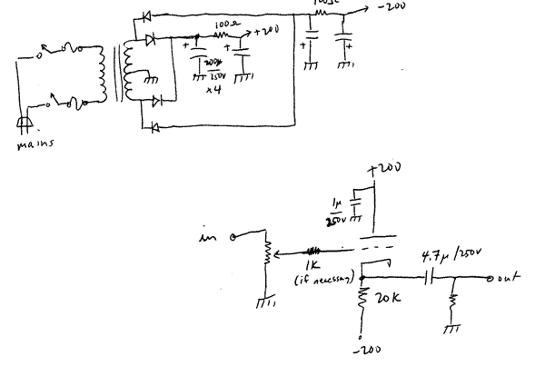

SY said:Just one more plug for simplicity.
Thanks Sy for taking the time to draw a schematic but I'm not following how you have split the rails into a bipolar PSU in the diagram. Can you point out the specifics? It's probably just layed out a little differently than I am accustomed to seeing it.

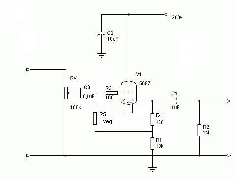

A self-biased circuit will work best with a resistor to ground or low impedance at DC like the choke loading. The resistor seen to ground at DC then sets the DC operating point at the cathode. This will be tricky with a CCS with very high impedance.
It's just a plain vanilla full wave bridge. If you want to get fancy, you can substitute chokes for the resistors in the filters, but for a unity-gain high-level stage, it's overkill.
SY, when using large negative voltages to tie the cathode resistor to, you will blow the grid if the positive voltage fails for some reason with the circuit shown.
A diode will take care of that, if it's a worry (one connection would be the cathode of the diode connected to the cathode of the tube, the anode of the diode to ground- it will limit the swing to 7 or 8 volts, but that's much more than required in this application). For me, it would be a worry if I'm using rare NOS tubes, but otherwise no; preamp tubes are pretty cheap compared to major power supply components.
I've built and used quite a few preamps using variations of this circuit (usually servoed instead of the output capacitor) and haven't lost a tube yet.
