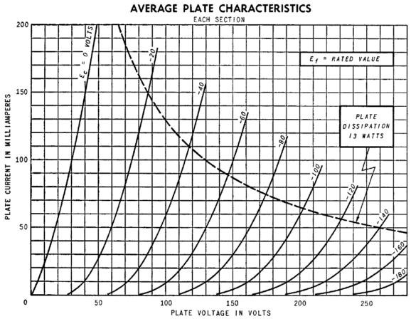

For the 6336A: Bias of -84V with Vak=250 gives 50mA for each triode, 100mA total. BUT if the bias drops to -75V then each triode will draw 100mA! The 6336A is a big powerful valve and anode current is VERY sensitive to cathode bias.
For the 6080: With Vak of 250V the bias would need to be -140V to hold anode current at 50mA.

thanks for help...Now, the bias voltage for 6080 is 125 volts, not 80. But it stays at 50 milliamps for 10 seconds, and then it walks and rises. I also saw the 120 milliamps, so I turned it off quickly. The triodes are the same, the tubes are new and good. I bought about 50 to 6080 before. It is true that the bias fix is not good for these lamps. But it is clear that this device has been working for years. What should we do now?
