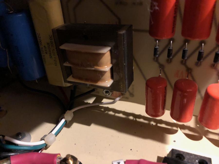

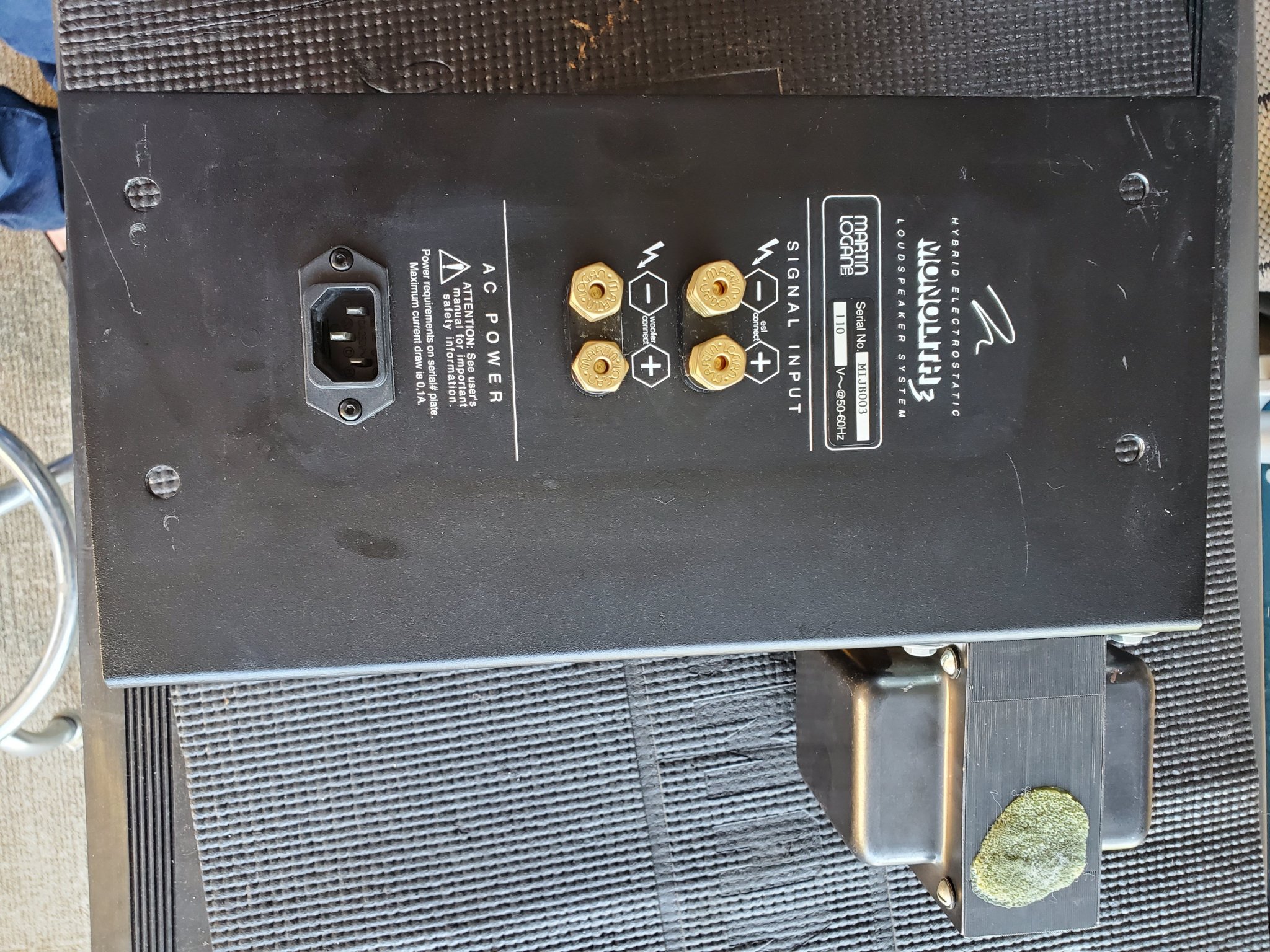

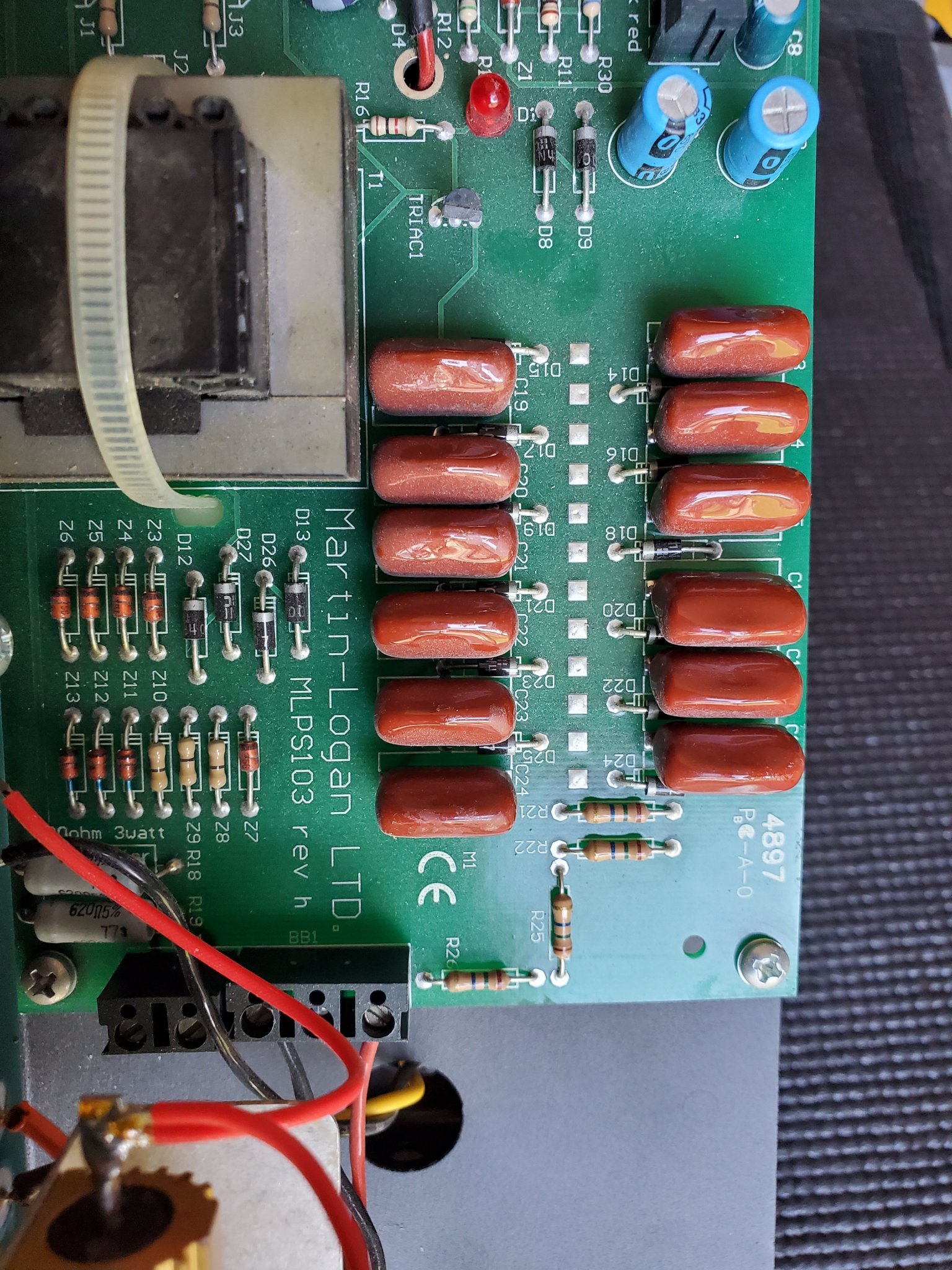

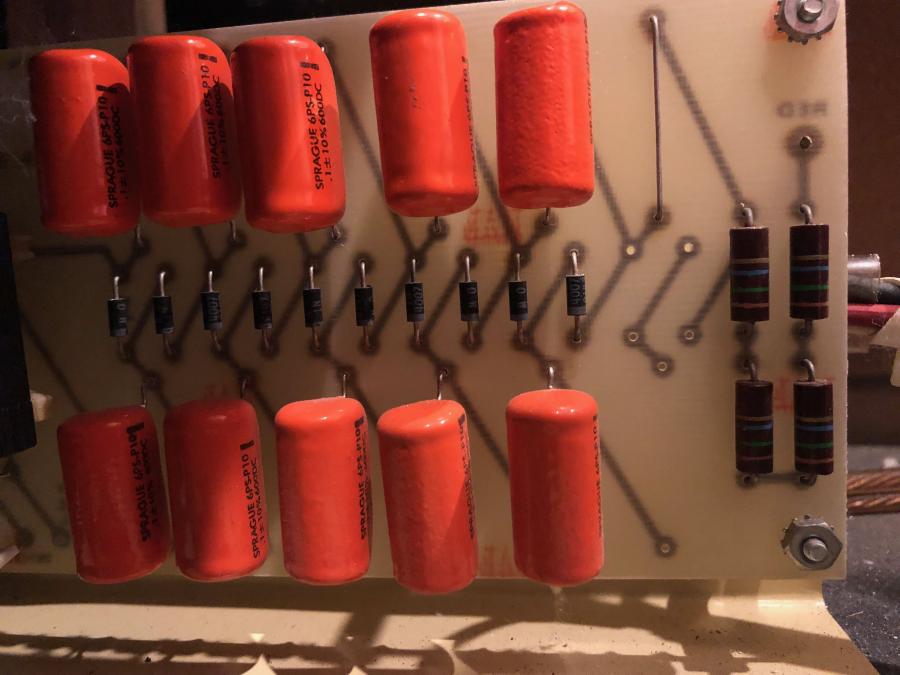

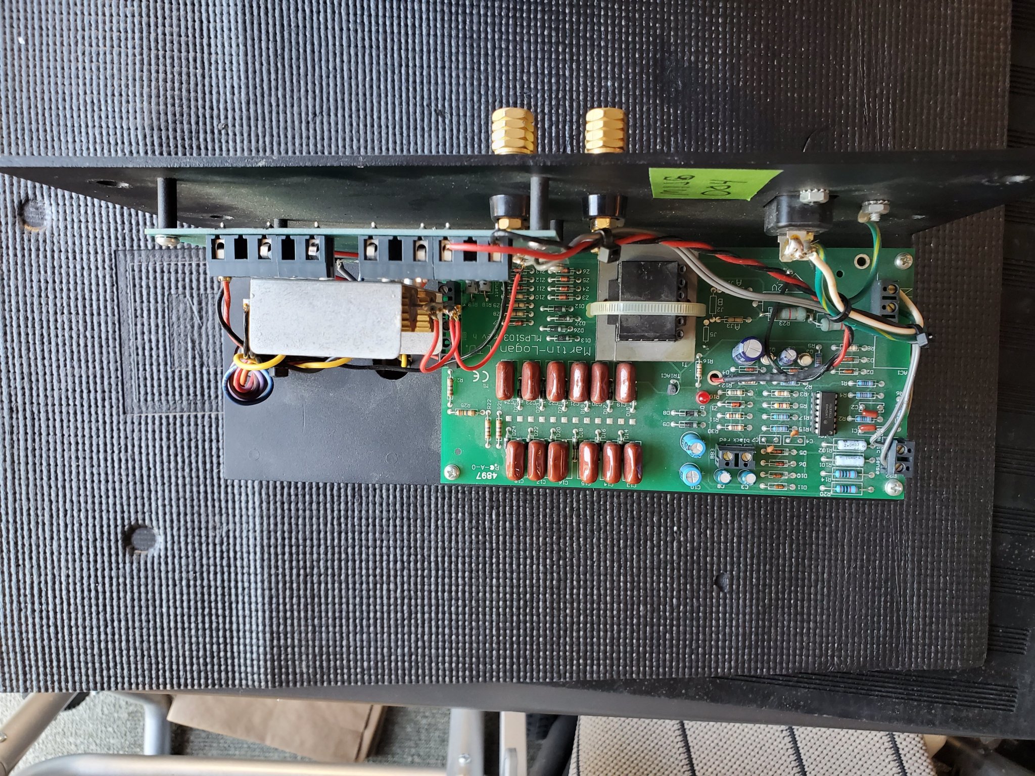

I'm not sure where/when I got them, but attached are some pics of the Monolith I, and Monolith III power supply boards.
Inspection suggests both are putting out roughly 3.2kV
The Monolith I has a 10 stage HV multiplier fed by 230Vrms. (230*sqrt(2)*10 = 3.25kV)
...a bit sketchy with 650VDC on caps rated for 600VDC
The Monolith III uses a newer HV circuit with 12 stage multiplier and Zener string limiter set to 271V. (271*12 = 3.25kV)
The Aerius came with 2 different versions of HV power supply depending on age. Both I believe produced 2.4kV.
Either can be modded to match the 3.2kV Monolith bias value if desired at some point in the future.
It will be safe to use the Aerius interfaces to test the Monolith panels.
As mattstat mentioned, the SPL will be down a few dB and the HF response will likely suffer a bit due to the larger capacitive load of the Monolith panels.
But, you will definitely know if the panels are operable or in need of new conductive coating on the diaphragm.
