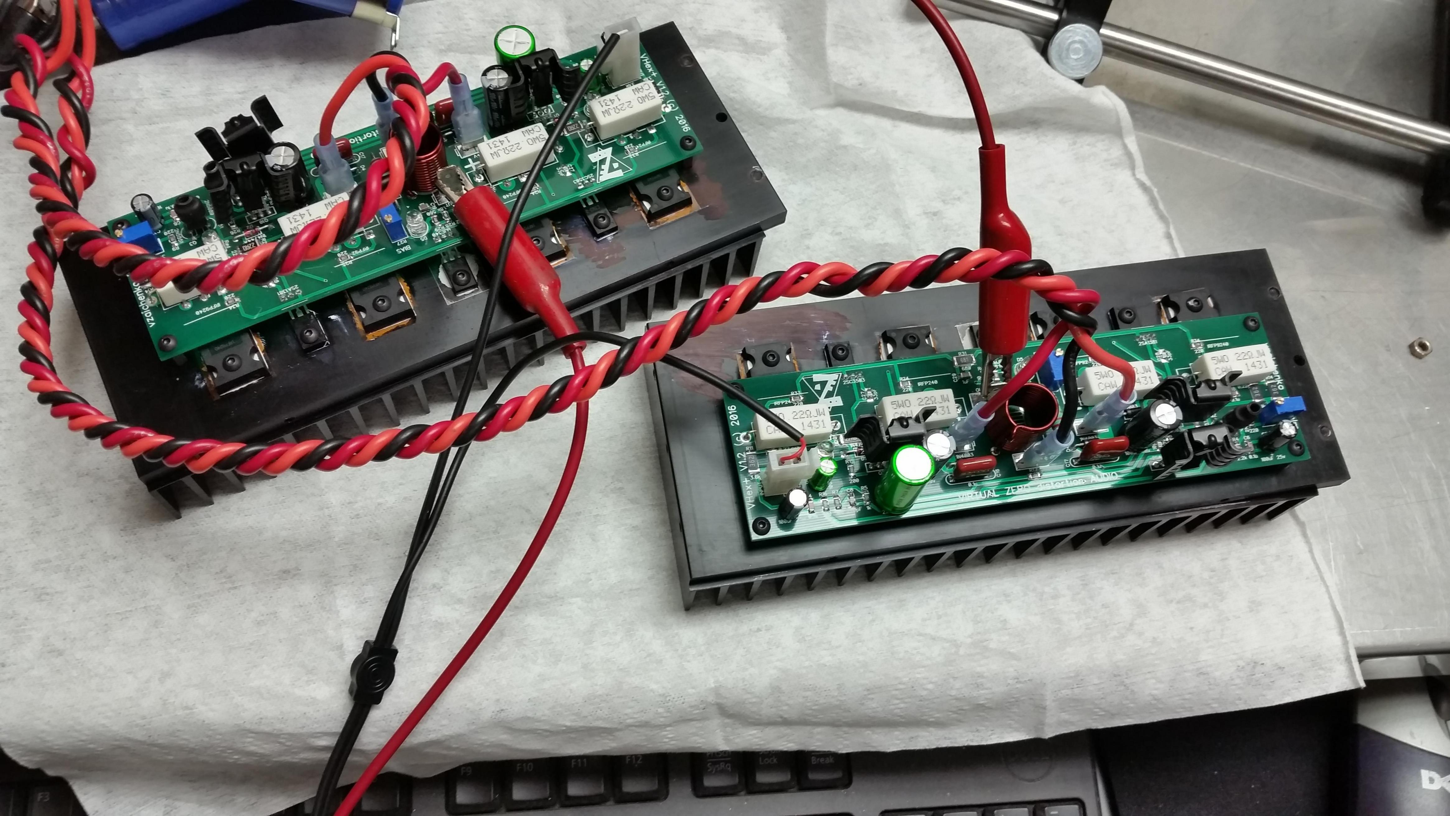

This circuit is specifically designed for the lateral MOSFETs (K1058/J162). Their bias conditions and input capacitance allow biasing with a resistor and driving them from VAS directly.
Switching to HexFETs (such as IRF530/9530) will require rather significant changes:
1) You will need a bias spreader - transistor, placed on the main heatsink, tracking the temperature of the output HexFETs and regulating the bias accordingly; otherwise you end up with thermal runaway.
2) You will need an emitter follower in front of the HexFETs - their high non-linear input capacitance requires driving them with low output impedance stage.
As an example, see my design of VHex amplifier. Note the the spreader and the EF buffer in front of the HexFETs.
Attached picture is showing what the boards look like (this is VHex+ with 2 pairs of output devices).
We sell the boards, by the way, if you are interested, $13.90 for the board, $26.90 for the set of 2 boards.
Valery
