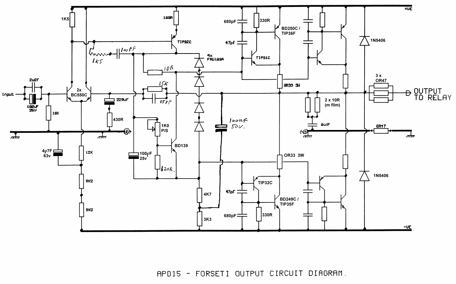

Bias setting for Alchemist APD20mk2

there is some information and diagram on their archive site but no diagram for the forseti APD20, only the 15.
https://www.alchemisthifi.info/ranges/forseti/alchemist_forseti_apd20a_power_amplifier.htm
Thanks but when I put my hand on top it's almost cold after some warm up period and that doesn't seem right.
I also have the Nemesis and it gets a lot warmer.
So I am suspecting the technician to have set the bias too low. Also I think it doesn't sound the way it should.
But I need an argument to make the technician have look at it again. That's why I asked for the bias.
The technician said it was dialed in at 10 mV??

10mV without supply voltage, nor where and on what it was measured means nothing.
With a supply voltage and measuring the consumption at idle on each channel (for example by removing the fuses from the positive power rail of each channel and bypassing them with an ammeter) could give an idea based on on the dissipation in W at idle for a Class AB, but once again, these would only be estimates.
