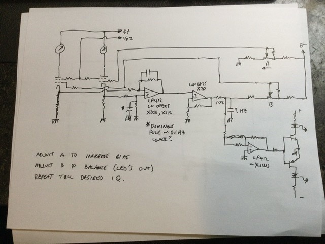

A couple of us usual crackpots have been in discussion on the I&A forum trying to guide (yeah, right) a newbie-ish who was thinking about building a “big” amplifier for bass guitar using sweep tubes. Something about the size of my big 6550 monoblocks. In principle its quite possible, and pretty sure I could make it work as a demo. I’ve built a 135 watter around a quad of 26DQ5’s and it works perfectly. The only trouble I had with it was a vintage tube in the phase splitter with h-k leakage. Once corrected I had zero trouble. BUT some of us have bigger plans on the horizon. Bigger tubes, more of them, and therefore more opportunities for problems. The biggest of which is probably keeping the bias balanced. I don’t want to have to rely on precarious adjustment over time. These big sweeps aren’t necessarily matched, and probably drift over time.
I was thinking of an auto bias which would allow the cathode currents to increase under drive (unlike many approaches), but keep them in balance during the bias-up procedure and while in operation. The tubes would be individually fixed biased (since I know this works with random sweeps), and work in pairs. The idea would be to be able to have multiple pairs running simultaneously, however. Each with their own bias control. Id have to figure out the gain structure, and where the dominant pole needs to be (pretty low). I had something simplified auto-biasing a pair of un-matched type TIP transistors on the bench years ago, with large emitter resistors which somewhat limited the open loop gain, but it worked. Deliberately upsetting one side by injecting base current resulted in an increase in the other to match, until it ran out of headroom. And the error voltage would follow. I’m sort of out of actually building anything for the moment due to recent injury, and just looking back at this because I planned to use something like this on The Big One, and The Big One has come up yet again. Might not go anywhere - but I figured this needs its own thread if I want to explore it. Ive got several pairs (dozens) of “disposable” 20 watt class sweep tubes to play with, when I finally get to put this to hardware.

This could work well with some additions.
  • you must keep bias low before heted up
  • during heatup wiat a minute or so before attempting to adjust bias
  • ignore bias except for abnormal current during play ( as protection )
  • some circuit to detect silence and thus enable adjustment
  • maybe remember bias settings at power off to restart faster.
Without a microcontroller I don't see how it could be done right for class AB
Probably not for auto bias. The intention here is to manually SET the bias, but keep the other side in balance. In principle, manual adjustment of the other side would not be needed, but getting the pot set to minimize error voltage will maximize the headroom for additional correction. The LEDs should tell me when I’m in middle of the window - when the op amp is only making a small correction at quiescent. If the gm on one side is weak it will introduce a DC offset under drive. The op amp can then correct this by upping the bias in the weak side - on the fly. And reduce it back slowly at idle.
You could do that.. but you would have to periodically mute the amplifier to get cathode current measurements. If you only measure during start up its pointless if the amp stays on for long times.
Moving average filter in software could work, or trigger the ADC to take a cathode current measurement when both anode voltages are more or less equal

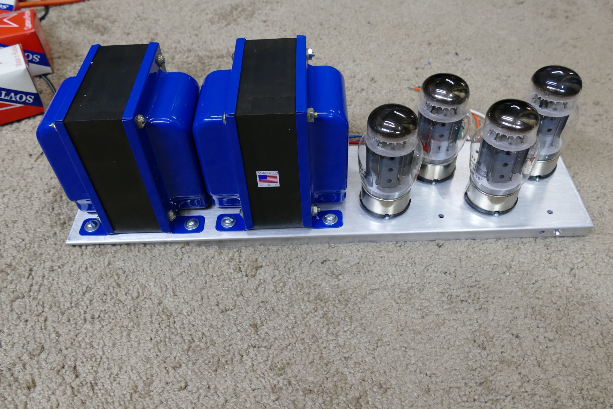

I had several steps planned for “the big ones”. First, a prototype of the “350” watter. Using the 8T800 as the OPT. Eight of those 21EX6’s ought to drive it, on 700 volts (expected to reduce to 600 at load). Once working, go to the 6HJ5 which is a more modern better tube. Got a batch big enough for a stereo pair plus enough to retube. And I just ordered some spares. The catch is that it’s 8 ohm only, unless I want to drive 700 ohms instead of 1400, and reduce the supply voltage, requiring higher current tubes. For THAT exercise, I have a batch of 21LG6, which can push more current without using up my 26LW6 stash which I need for The Big One. For that exercise, I may use a pair of interleaved 36V toroids per channel I have laying around and limit the supply to roughly 400V at load to get the target 340V peak across each primary, and get the right power at 4 ohms.
The big one will be 4 ohm only, since no single driver box can handle the power anyway. That 15T950 works out to 1k a-a. If I can get 700V at load, it should make 800 watts. 800V at load to get a kW is probably just wishful thinking, even with a 2kVA supply. Six paralleled LW6’s will stay around 43 watts each at max dissipation, and most of the time it would be less. Don’t need crazy current - I may even get away with 100-110V g2. Of course, I’m going to want TWO of them in the end. Think of it - those driving four of my 32 cubic foot 30 Hz bass horns, 350 per side driving horn loaded 12” mids (12MH32’s), and a pair of 2” D3300 compression drivers driven by my 6550 “bass” amps.
In the 26LW6 department ive managed to scrounge together 24 of the GE large bottle single plate style, 35 of the smaller bottle Sylvania, and a handful of oddballs. One good pair of the double-plate variety, and one good pair of the 36 volt large bottle GE. Those will get used for something special. Will any of it ever get built? You bet, just a question of when. I didn’t think i’d ever see the day when my new house gets built, and that’s moving closer and closer despite my recent foot injury.

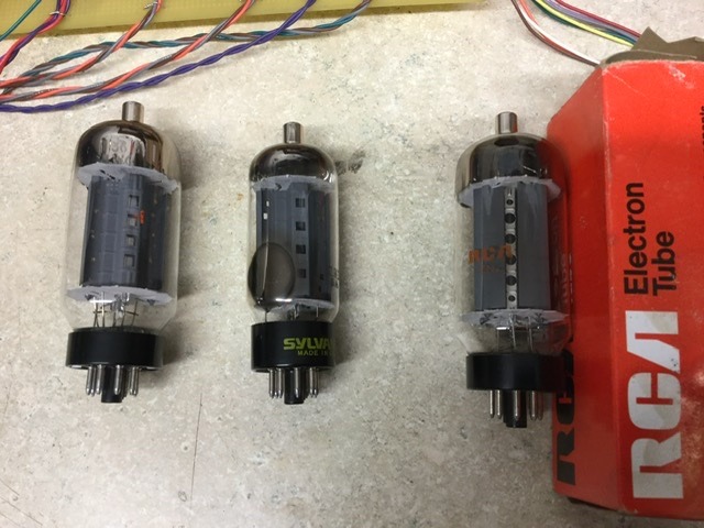

When you say double-plate variety do you mean that it has two smaller tubes inside wired in parallel like the 6KN6 in the first picture? Early 6KN6's had two smallish sweep tubes inside wired in parallel. This gave the highest peak current capability (1.5A) of any sweep tube I have ever seen, but many were poorly made, and even a good one will red plate in the area where the plates meet. These can often be found cheap at hamfests since they will not work right in RF power amps due to high capacitance. The later 6KN6s were simply remarked 6KD6s with one set of guts.
The second picture shows a fat bottle 6LW6 with two large fins attached to the plates at the seams. These can eat a lot of power without redness, but this is one of four bad ones that I have. This tube was well made and could eat 80 watts with no hint of redness. I was using them in a triode wired SE amp which was basically a hacked up SSE board feeding a Hammond 1628SEA OPT. The first version ran about 400 volts of B+ in cathode bias and the cathode was around 75 volts. In about 6 months of daily use two of these tubes went gassy and into red plate runaway. The second version of the amp got a different power transformer and the OPT was rewired for 2.5K ohms. B+ was adjusted to put the screen to cathode voltage at 275 (spec is 280) with the total dissipation just under 40 watts. It took longer, but two more tubes died before I dismantled the amp.

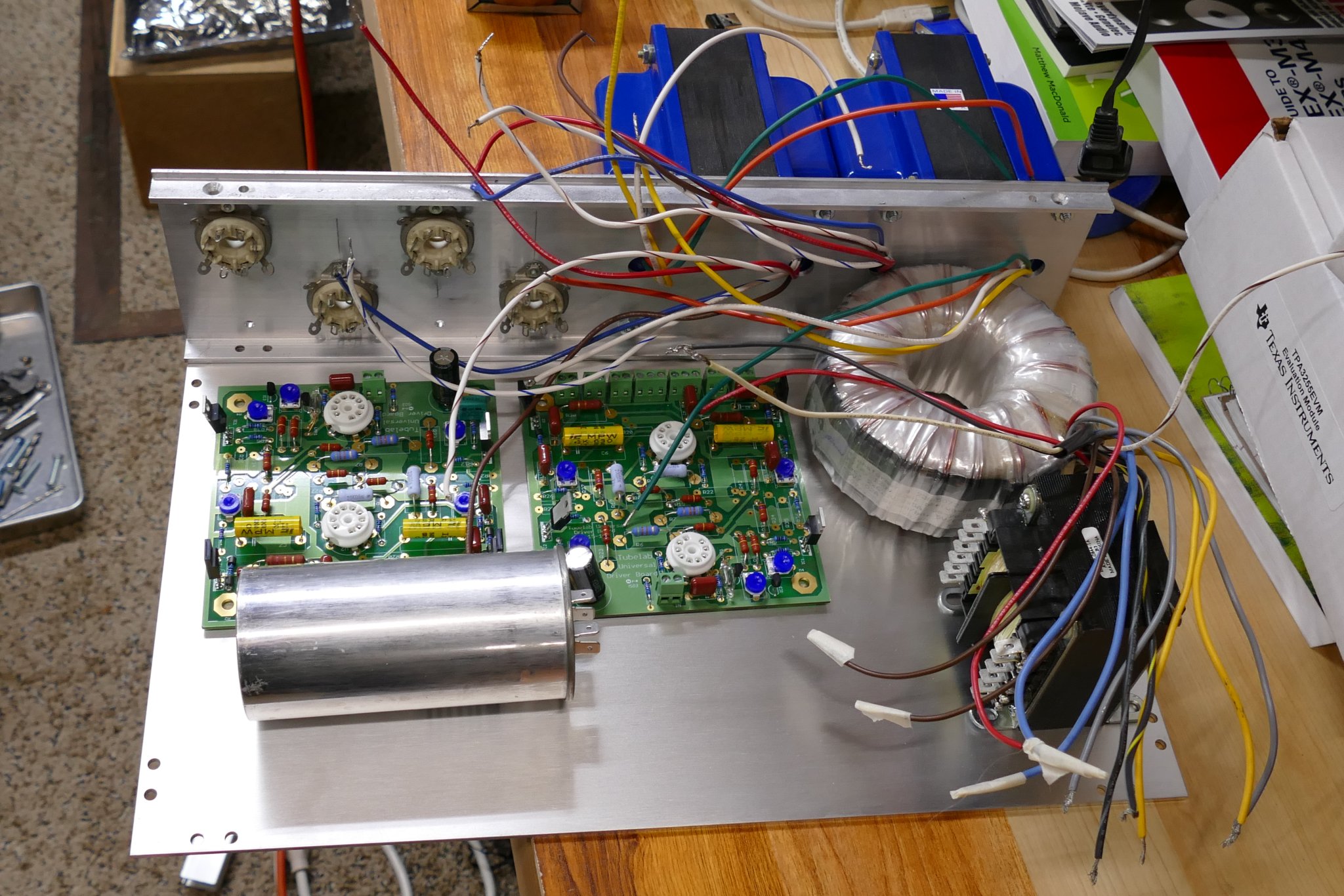

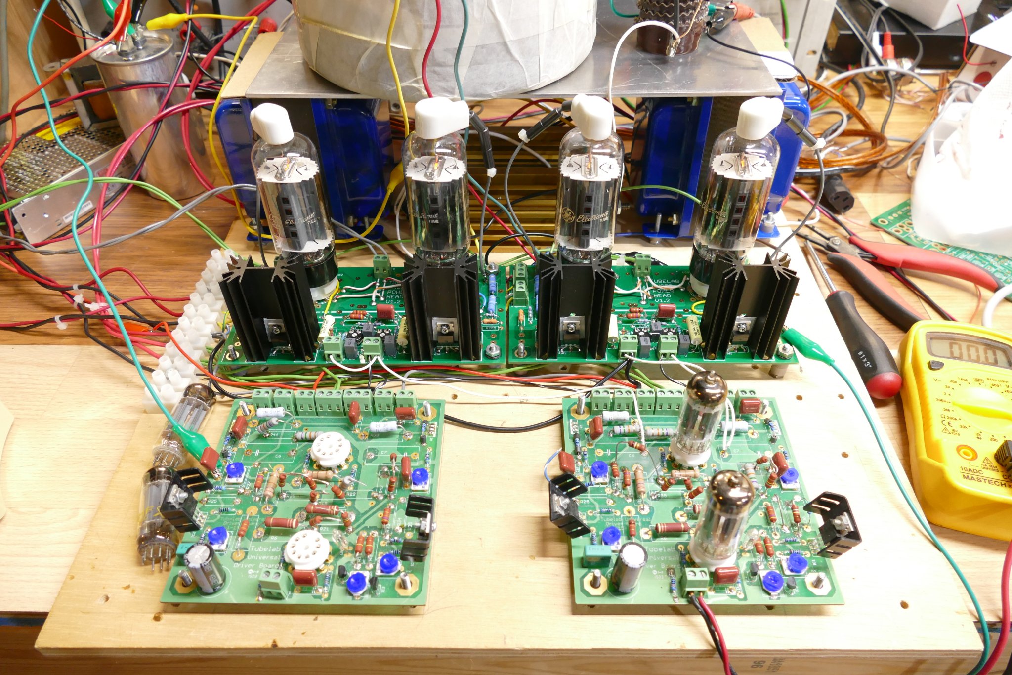

The "proof of concept" as we called my prototypes at work is this. The final circuit will be something like this with either 2 or 3 UNSET Power Head boards per channel and one Universal Driver board. This test happened last December. The little SMPS in the upper left corner lights the 26HU5's and a big variable supply is set on 625 volts which is delivered to the AC polypropylene cap via some Radio Shack clip leads. Power output is 350 watts @ 0.817% THD and 525 watts @ 3.79% THD with visible clipping. There is a slight red glow in the tube plates in a dark room at the 350 watt level with none seen at full power (normal behavior and idle current dependent).

The large double plate variety is the one on the far right. There are two separate LARGE plates, but the guts in the middle are the same as the others. You can see the beam plates. The ones I have quantity of are the other two, after a couple years of scrounging. A couple of other onset twosey oddballs. I thought that one on the right was an oddball till I got another, and both work so they’re a pair. I think I got the first one at Stan’s. The second came from a “mixed brands” lot. I was actually excited to get it, rather than saying WTF is this???
How many to parallel? 5 would deliver all the peak current needed with an unloaded supply of 900V, and be ok on dissipation with a full load supply of 700V. When I load test the final supply I’ll see if I want to bump it up to 6. Yes, a 12 tube amp. With 6 drivers, LTP, and front end - but those are all $3 mini 9 pin except the 6CG8 LTP which is a bit more. The smaller variety will work sustained with 4 pair of the 24-28 watt tubes. So naturally I started thinking about bias stability, especially considering te end use.
The circuit I’m planning isn’t anything “special”. Just your basic Mullard with individual k-followers driving the output tubes. A low impedance on g1 should help with the drift, and provide an easy load for the phase splitter despite driving the universe with it. Now why would anyone want or need to do this? My real hobby is PA. I have a 30kW SS PA, all of which only sees action once in a blue moon. But its a blast. I’m on that road to retirement (they don’t WANT me to quit but the end is in sight). But an all tube PA that’s big enough to do something real with has been on the bucket list. Considering this use, even if only occasional, a bias controller seems very prudent. Show stopping amp failures or shutdowns is a non-no.

"The large double plate variety is the one on the far right. There are two separate LARGE plates, but the guts in the middle are the same as the others."
I have some of those. I think that they are 6LW6s. I guess I never looked at them close enough to see that there were two separate plates. I moved all of the valuable tubes over to an old house trailer on the property when the Radon guys were in the basement busting concrete. The 'LW6s are still in there.
"Just your basic Mullard with individual k-followers driving the output tubes. A low impedance on g1 should help with the drift, and provide an easy load for the phase splitter despite driving the universe with it."
