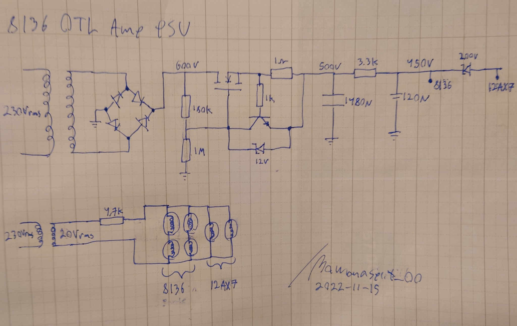

The PSU schematic is now attached

The actual power supply circuit is not posted or simulated.
Seems like a LF instability propagated through the power supply.
Use a lab supply instead to verify this.
Well I guess maybe its time to see if my HP 600V supply works then I suppose 🙂
The PSU is a little fancy I guess but nothing I'd expect to cause anything like this and the voltage on the Fluke multimeter looks stabile to within a volt for both the 250V and 450V. On the voltages where I see this strange waveform it varies significantly so I'm not sure it's sneaking through the HV supply.
Either way, here is the schematic(on a piece of paper because I don't have a computer close atm):
Add a decoupling capacitor for the low voltage input stage as well. Perhaps an additional RC network for it is best.
If you use the HP supply, the oscillation may still not go away. The 200V Zener impedance could be responsible.
You need a diode before the 1780u capacitor or the MOSFET will not drop voltage correctly (because of back-feed through the MOSFET body diode).

It's there, I just forgot to draw it 🙂
