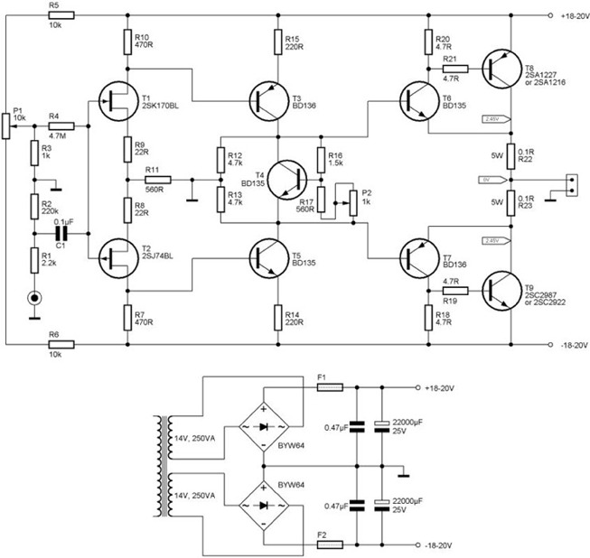

Bias in a classical current feedback amp - influence how?
Jocko,
I have to agree with your observations with most CFB circuits I have built. They sound clean, fast, have low distortion but for want of a better word the seem to lack a sense of 'swing' when the music gets going. Increasing the bias does not seem to help much. The same circuit with no global feedback seems to be much better.
If possible, how about posting your non-global feedback design?
The design below seems to have good reviews and was posted on the forum sometime back.
Jam

Jocko, what was your opinion about CFB? Your client seems to be very "sugar pill" sensitive.
I think that CFB seems to be qutie alright as long as the amp works as intended. The korean guy Hyun Joon Rho nearly wets his pants in thrillment (is this a real word?) when he built my Alexander type of amp.
http://www4.head-fi.org/forums/showthread.php?s=&threadid=35074
I myself have so far no objections against CFB.
I have fooled around more with SPICE and notice that you can gain a little if the current mirror has a small current gain. 3-5 is good for the performance.

I have help a friend to build an Alexander amp with very good results, I would say. Electrically "pure" performance and soundwise OK but I hadn't the opportunity to really test it.
Jocko, could you tell me your problems with it, more exactly? Was it an Alexander amp-like amp or the basic symmetrical topology like my picture in the first post?
I will build a CFB amp but now I'm sort of gathering opinions but still I'm a little bit confused because noone seems to really point out the weakness' of the amp. Quite in contrast to some people which make headphone amps with CFB and nearly wet their pants in delightment.

Problems:
(Apply to the Alexander type and the one that you posted.)
It needed an inductor on the output. Loads over about 10 nF made it go nuts.
Inverting version is more stable.
Discrete versions needed expensive parts like MAT-02s, -04s.
Not a problem, but.....it could not be "tweaked". Nothing....even bias seemed to make any diffenence.

not to correct you or anything like that.
what GPBW have you set it to?
You see i have one at home working with no output inductor and no expensive matched parts. actually they are just thrown into to the board.
on the other hand it have a DC servo.

You think that I can remember that far back? The Alexander did not require matched parts, just the discrete one. Should have been more clear on that point.
I did not have problems with capacitive loads. But my buddy had dealers that sold cables that were very capacitive. Made by a company that he used to be buddies with.
