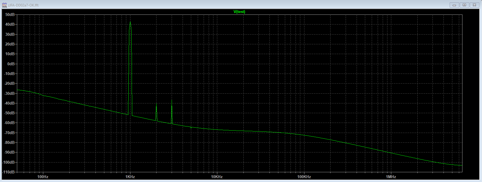

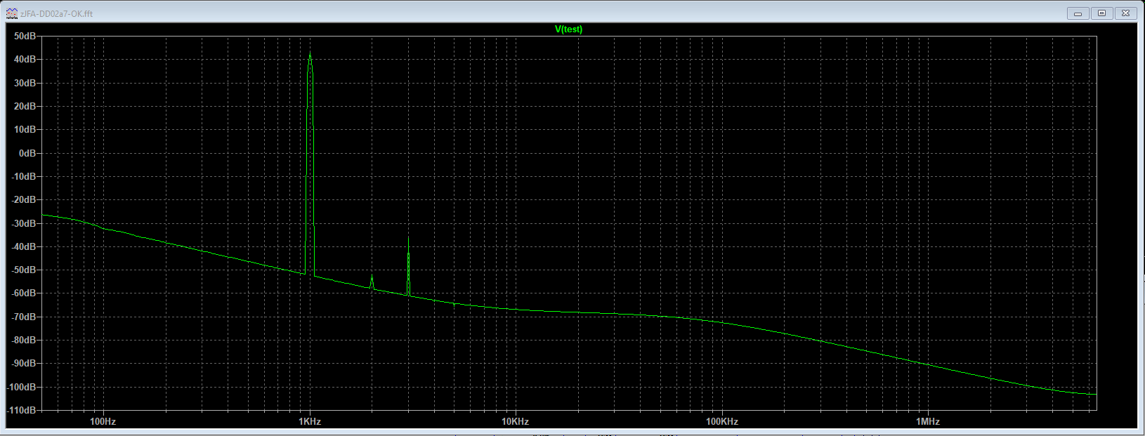

Another way to illustrate this with simulation: here's an amp I'm thinking of building, maybe one day, for my Jecklin electrostatic headphones.
Nothing fancy, just 2 stages of differential amp. The 1st pic shows the harmonics content of the amp as-is, the 2nd pics shows how H2 can be reduced by adjusting the balance of one of the stages.

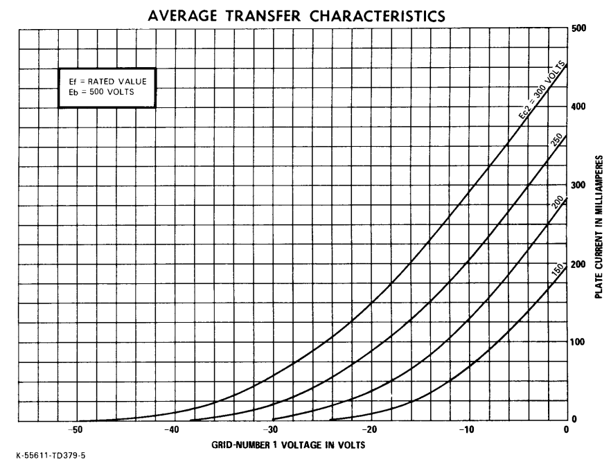

You can see that in the *Transfer Characteristics": the slopes of the curves, or transconductance, change significantly below 25mA or so.

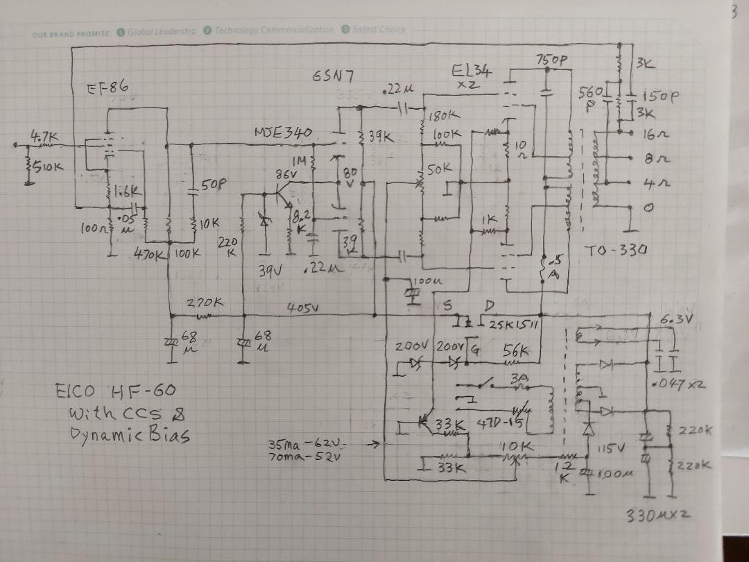

FYI, I build a pair of power amps base on the EICO hf60 circuit with original output and power transformer, I don't like the manual recommend bias at 65ma. I think it may to high for el34, so I modify the bias circuit, add a small signal pnp transistor and few resistors, in this modify the bias voltage will less negative when the output tube cathode 10 ohm dc voltage increase. I had set the bias current to 30ma and no crossover distortion at full power output.
