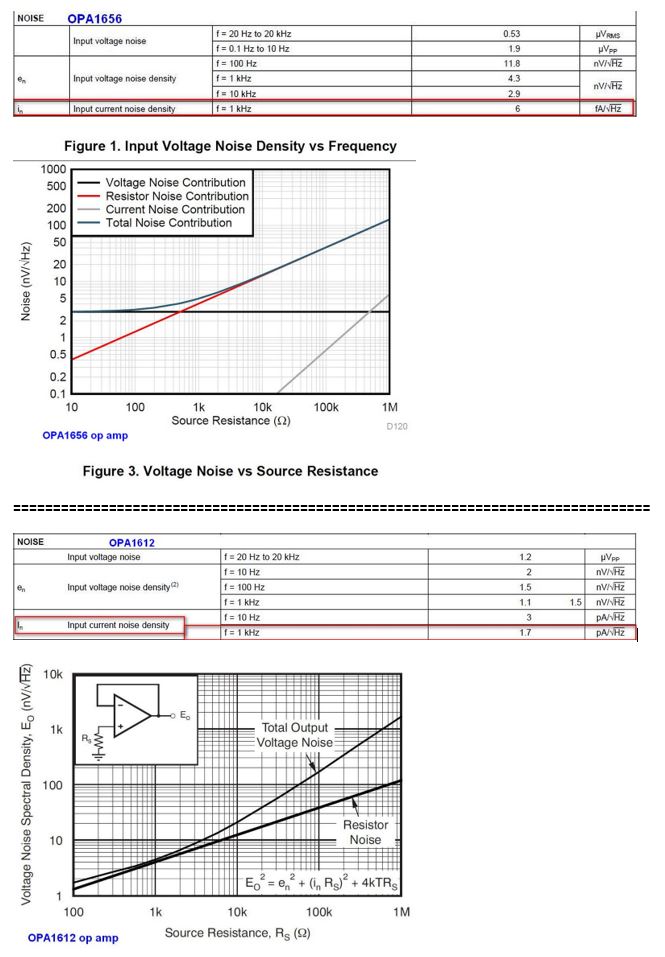

Bias compensation circuitry injects current noise into the inputs, but often this is closely correlated for the two inputs.
If the impedance seen by each input is different (impedance, not resistance), then this extra current noise doesn't cancel and will be converted into voltage noise across the inputs.
The datasheet current noise spec often is done using a circuit which balances the impedance seen by each input, in order to hide this extra source of current noise from you...
When noise matters (high gain MC phono amp, etc), its sometimes the case you can't balance the input impedance (without adding more sources of noise...), so the datasheet current noise spec won't apply.
Its really important to know this compensation current magnitude in order to estimate the current noise actually seen in realistic circuits, but often this is hidden from you.

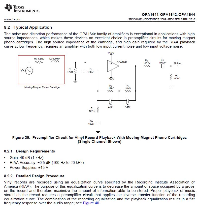

The optimum choice of op amp and resistor selection depends on the specific circuit use, such as input impedance, output load, input/ouput signal swing, required gain, bandwidth, signal levels, noise and distortion requirements.
If one is working with low impedance audio circuits, say less than 2k impedance, then the BJT input op amps may work out better due to lower input voltage noise.
If the circuit impedance is say above 10K ohm, then a FET input op amp may be a better solution, since it most likely has lower input current noise. The BJT input op amp with large input impedance resistors will have the effective input voltage noise swamped out by input current noise through the large input resistance.
Bias current through a resistance will drop a voltage across the resistance, if the input resistance seen by the input bias current are largely different, then there will be an input offset voltage due to the input bias current through the different effective resistances seen from the two input nodes of the Op Amp. The DC input impedance imbalance is the issue for input DC offset.
Using a low input offset op amp effectively, also requires careful attention to input impedances, value resistors used, input bias current, DC gain and whether the output gets AC coupled.
All diode junctions have a non-linear voltage dependent capacitance (parasitic varactor) which can lead to harmonic distortion with a large source impedance and large voltage swings (such as in an input voltage follower application). For those applications, a dielectric isolated FET input op amp may be appropriate choice (one example is the OPA1642).
Also, if using FET input op amps, one must be careful about imbalance in the input impedance driving large nonlinear input capacitance with large unbalanced voltage swings.
In a MOSFET input op amp, the input bias current is coming from the ESD diodes on the input. In a JFET input opamp, input bias current is a combination of ESD diode and gate junction diode current.
Many low input bias current BJT input op amps either use super beta transistors or bias current compensation on the front end.
The op amp choice and circuit design approach is always a compromise of design requirements & tradeoffs. Every op amp is good for some type of circuit, the proper choice is dependent on the specific case.

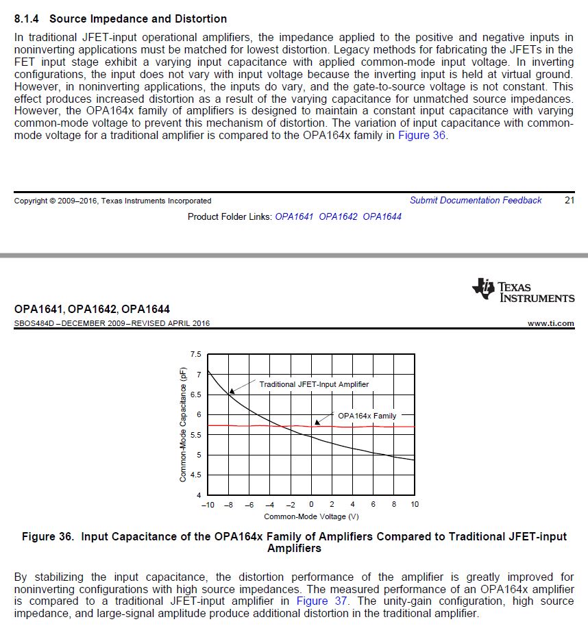

Yeah, I actually considered the OPA1641 for a phono preamp I'm designing, based on Walt Jung's two-stage, passive shunt EQ phono preamp. But I dumped it in favor of the OPA828 for it's trimmed offset voltage and high GBW. Current noise slightly higher at 1.2f versus 0,8f, but voltage noise is lower, 4nV versus 5. Either is dwarfed by noise from the 47K and cartridge anyways.
The 1642 has admirably flat input capacitance though... And the first stage only runs at 28db gain, so that it doesn't clip on high-frequencies before the second stage does. The way it's balanced, they both clip at the same amplitude at 20KHz.
So this first stage is working with a small signal and low gain. Is that flat capacitance important in this application?
And hmm... the 1641 swings closer to the rails than the 828, and that's important in this design, more headroom is better...
I might be talking myself into the 1641 haha... The offset's not a big deal I guess.

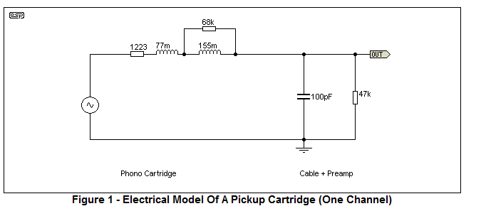

Just to be clear, its the imput _impedance_ that matters, not the resistance. Current is multiplied by any impedance, not just the resistive part, to give voltage. This is why low current noise is important for MM cartridges as they can have a henry or so of inductance, turning 1pA/√Hz of noise into maybe 50nV/√Hz+ at 10kHz - making it pointless to have ultra-low voltage noise figures for an MM amp, the current noise should be addressed first.
1H is 63k ohms of reactance at 10kHz, MM cartridges 1k or so of source resistance is insignificant by comparison across much of the audio spectrum.
Even the professionals get this wrong, I've seen some datasheet for an opamp showing a phono preamp and miscalculating the noise performance by assuming an MM cartridge is purely resistive...
