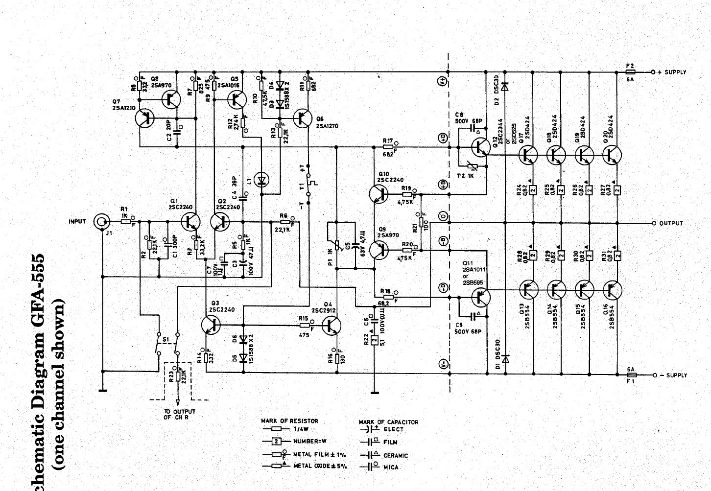

Is the adcom a quasi complementary output stage or a fully complementary EF output stage, or a fully complementary CFP (common emitter) output stage?
All of these need different biasing to minimise crossover distortion.

The Adcom is a quasi complementary output stage. Schematic attached:

What? thats surely a full complementary output stage. quasi is all one type such as all npn or all pnp, but that has npn high side and pnp low side output stage = full complementary.
Oops! Sorry. Yes thank you for the clarification.

Darlingtons generally need a fairly high quiescent current. Complementary pairs usually need a low current. I can't imagine how you set a quasi-, as that has Darlington one side and CFP the other.
6mV is a voltage, so over what resistance is this measured? Bear in mind that the current may be set a bit high, so heating up can drop it without creating problems.

There’s usually an optimum bias point that produces the lowest distortion in a given AB design. Go higher or lower and things usually get worse. It’s all documented ad-nauseam in various books. Now what you perceive as lowest and what an instrument actually reads as lowest may not necessarily be the same thing though.

A typical starting point, when you don't have the manual or the service tech alongside for advice, is to look at the emitter resistors, the big ones in the emitter leads of the output transistors, R21-28, I think. These will give an idea of how much mV you should read across them (hence bias current) for any transistor in series. Do these read O,22R or is that 0.82R?
I would expect them to be a more or less standard 0.22R, in which case a typical bias setting range would be 15 -25mV across each resistor (they will be the same as they are in series or parallel). However, if those Re's are different, I'd think about that first. When you do set a current, monitor it to be sure that warming is slow and steady.

The goal is to achieve a constant output Z for the whole range of operation, thus a constant Gm, because any change in Zout will reflect a change in voltage gain of the output stage. IOW, ideally Gm vs Ic should have no slope or a vertical line, from +Vcc to -Vcc. This is virtually impossible so we comprimise with the use of emitter resistors and bias current setting so that we can reduce the variation from Av=1 (ideally) of the output stage emitter follower circuit that is related to the inconsistancy of Gm that occurs at the zero current crossing. BJT's have very steep Gm vs Ic slope above a few 10's of mA. Mosfets are not the same. With Mofets the bias setting is less critical, as long as it is within a suitable range. BJT's need more acuracy.
If you connected one scope channel to the amplifier output and the other to the VAS output, you can compare the two signals as you adjust bias. When the outputs are under bias, the slope of the signal from the VAS will become steeper in order to make up for the drop in Gm (increase in output Z) at the zero current crossing. The result is more high order distortion products being created by the IPS and VAS. This is not an ideal situation because the BW of the global loop is limited.
As I said, these are not quite the same thing. Constant gm should be the aim; this ensures low distortion. This is likely to provide constant output Z too, but that will be affected by feedback.The goal is to achieve a constant output Z for the whole range of operation, thus a constant Gm,
BJTs have a very constant gm vs Ic relationship over a wide range of currents, but output stages complicate this, whether Darlington or CFP, because of the interaction between driver and output.
