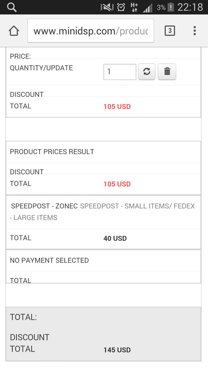

And Dsp wants around 40usd bullsht shipping fee by SF express for such a little package.40usd shipping for an item that costs 105usd is making people not to buy IMHO .Express Cargo is very bad for customs here too (I can send a package like it for 15usd by air mail in my country )HK post is even cheaper than our post. I wrote a message them by sending HK air mail but no response received
