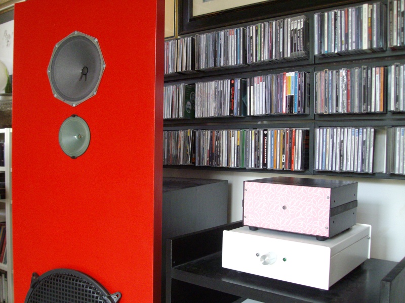

How to use two TA2024 amps with my diy 3 way speakers? One amp for tweeter+midrange (they are connected to the same binding posts) and one amp for woofer (different binding posts)? Can I replace the input capacitors in the "HF amp" with some more little caps (I have two nice russian PIO 220nF caps)?

No reason you cannot bi-amp using two Tripath amps. I am currently bi-amping home brew speakers using the 4 channnel Sure TK2050 board, and this works like gangbusters (and sounds a whole lot better than class AB amps I used to use). Total cost, with switching power supply and Radio Shack black plastic box for the amp, about $100. It is hard to do better than this. If your drivers are really efficient a couple of little Lepai 2020s would work, total cost $50 with shipping.
