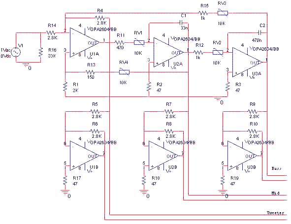

Made up a stat-var filter. Also made lovpas(30-600) and highpas (600-10K)freq adjustable. Then bass gain and mid Q adjustable.
At the end i figured it vise to add inverters at the same time. Then phase switch or balanced output is possible. Only one channel without power suply shown:

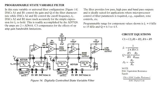

State Variable Filter
the state variable filter lends itself easily to use with the digital potentiometers from Analog Devices, Dallas etc. In fact, Analog Devices has one such circuit using the AD7528 Dual DAC:
http://www.analog.com/UploadedFiles/Data_Sheets/718586868AD7528_b.pdf
