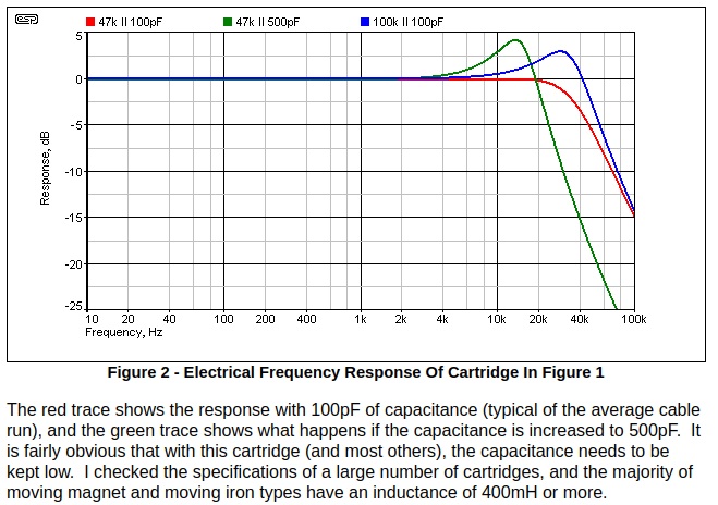

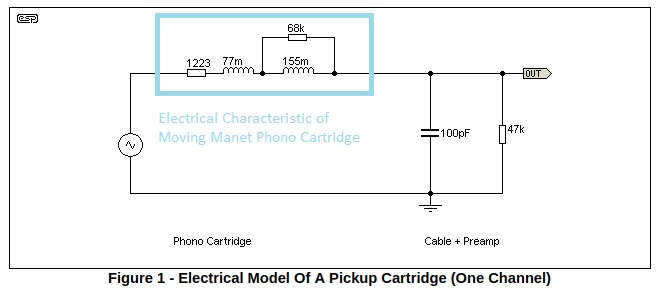

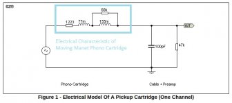

Since I have the diagrams already prepared for another rambling thread, here's the lowdown on very bad cabling.
If you have an inductive moving magnet record pickup attached to a 120 ohm phono cable, very bad things happen. The mismatch produces a capacitance that resonates with the inductive pickup. That might just be tonal, and not what I would call non-linear distortion. But the pickup, being a mechanical device then tries to jump out of the LP groove, which is nasty and non-linear.
It's never been solved really. But an 8 ohm loudspeaker attached to a 100 ohm super cable can only let the signal bounce around about 10 times. Well do the Math. Electricity travels at the speed of light, which is a Million times faster than Sound. If there's any effect it's nothing I can't fix with tone-controls.
As a keen audio man, I have more pressing problems to solve. Now must get on. 🙂
