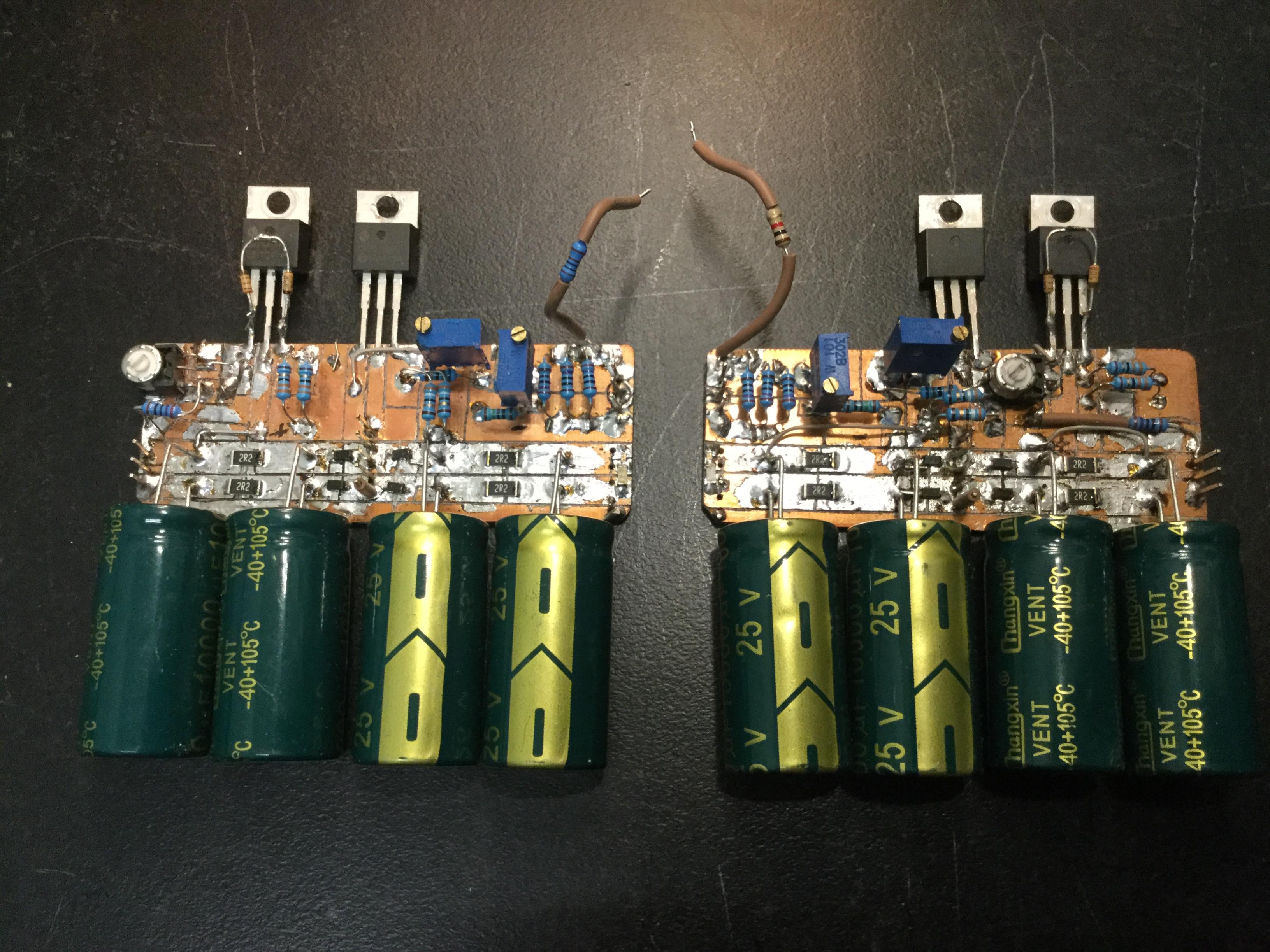

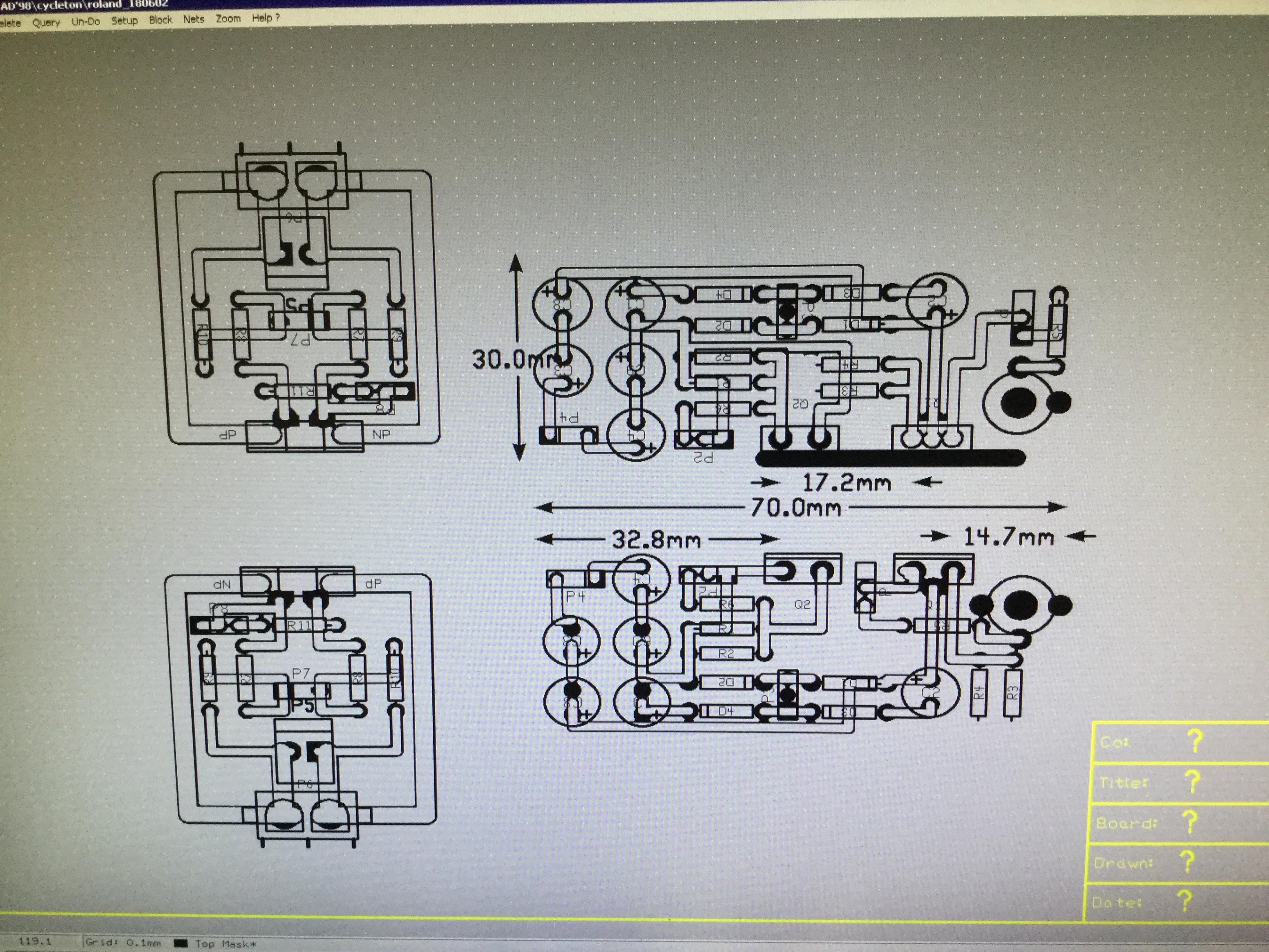

So far, it is nearly completion, waiting for PCBs etching, I think the amp will be a laughingstock for high end builders by my choice of non “audio grade” components (with an exception for the lateral mosfets), SMPS and CPU fan heatsink.
Cheers

Sounds very very good. Got that natural bloom in the sound.
Epuld be great of one can scale it to 50 watts & retain the same
SQ. Congrats

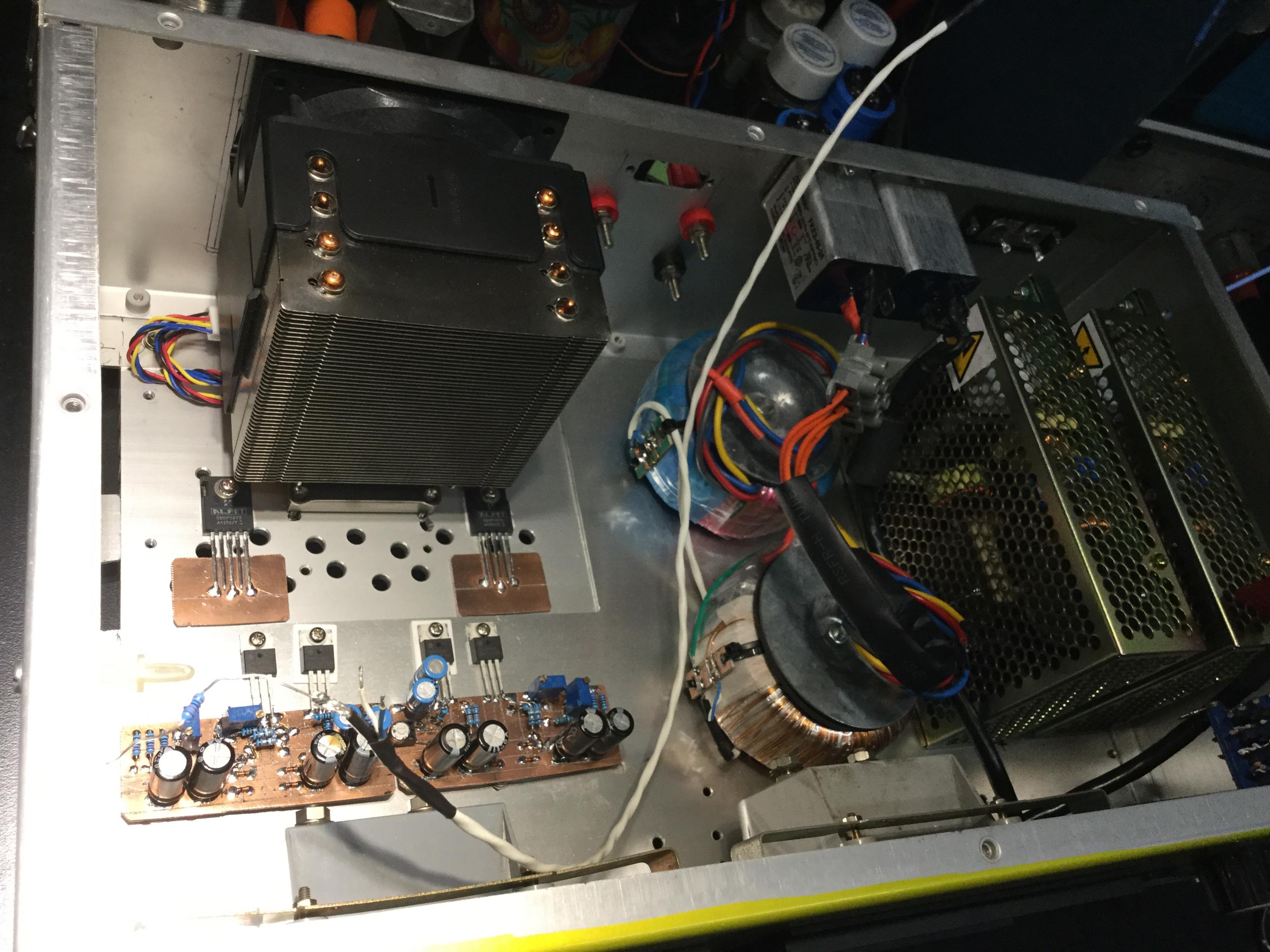

Btw are those smps psu that I see in the pic ?

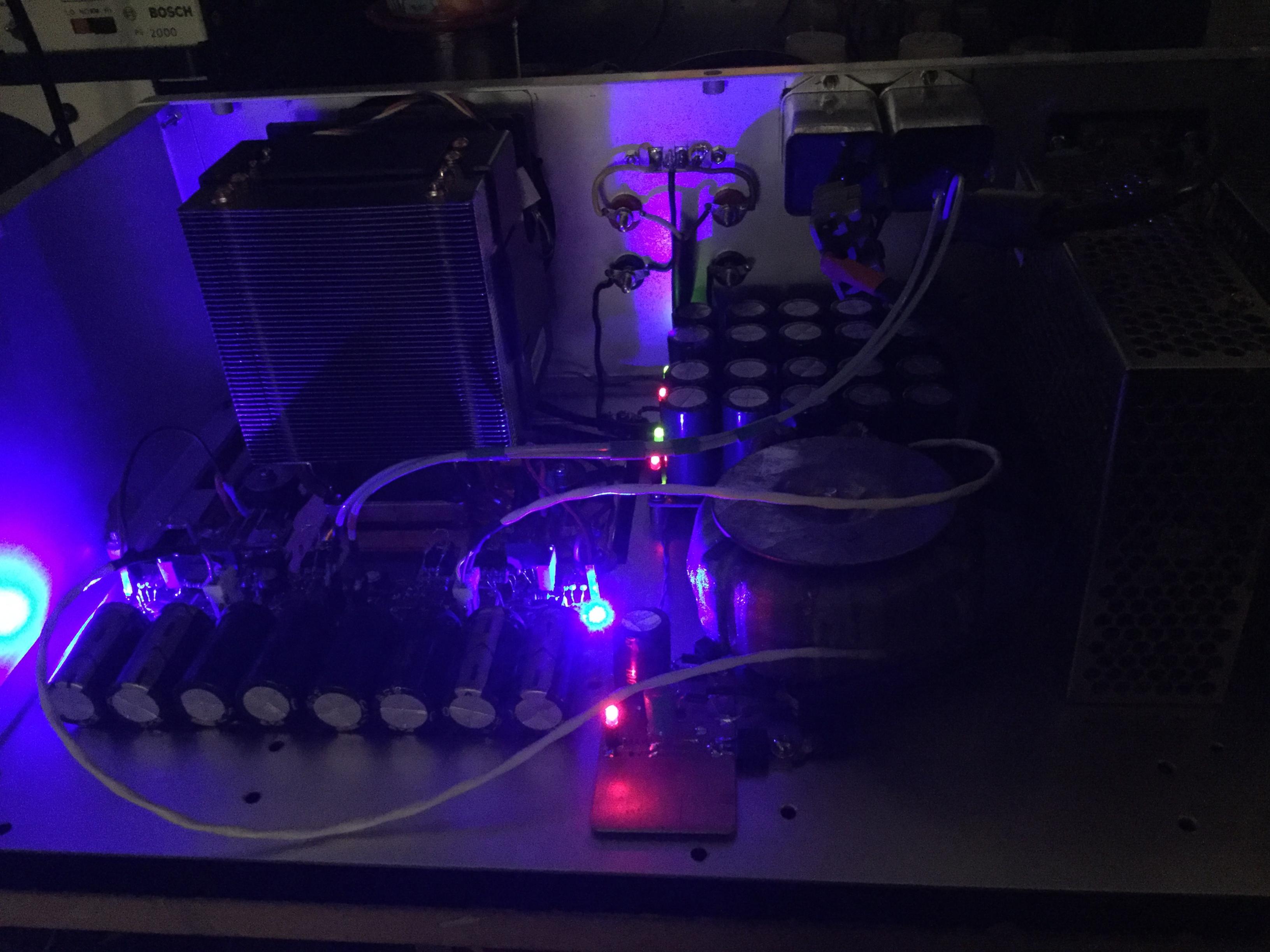

While I am waiting for a double shielded toroid power transformer, they are the work horses, +20V/2A and -20V/2A each

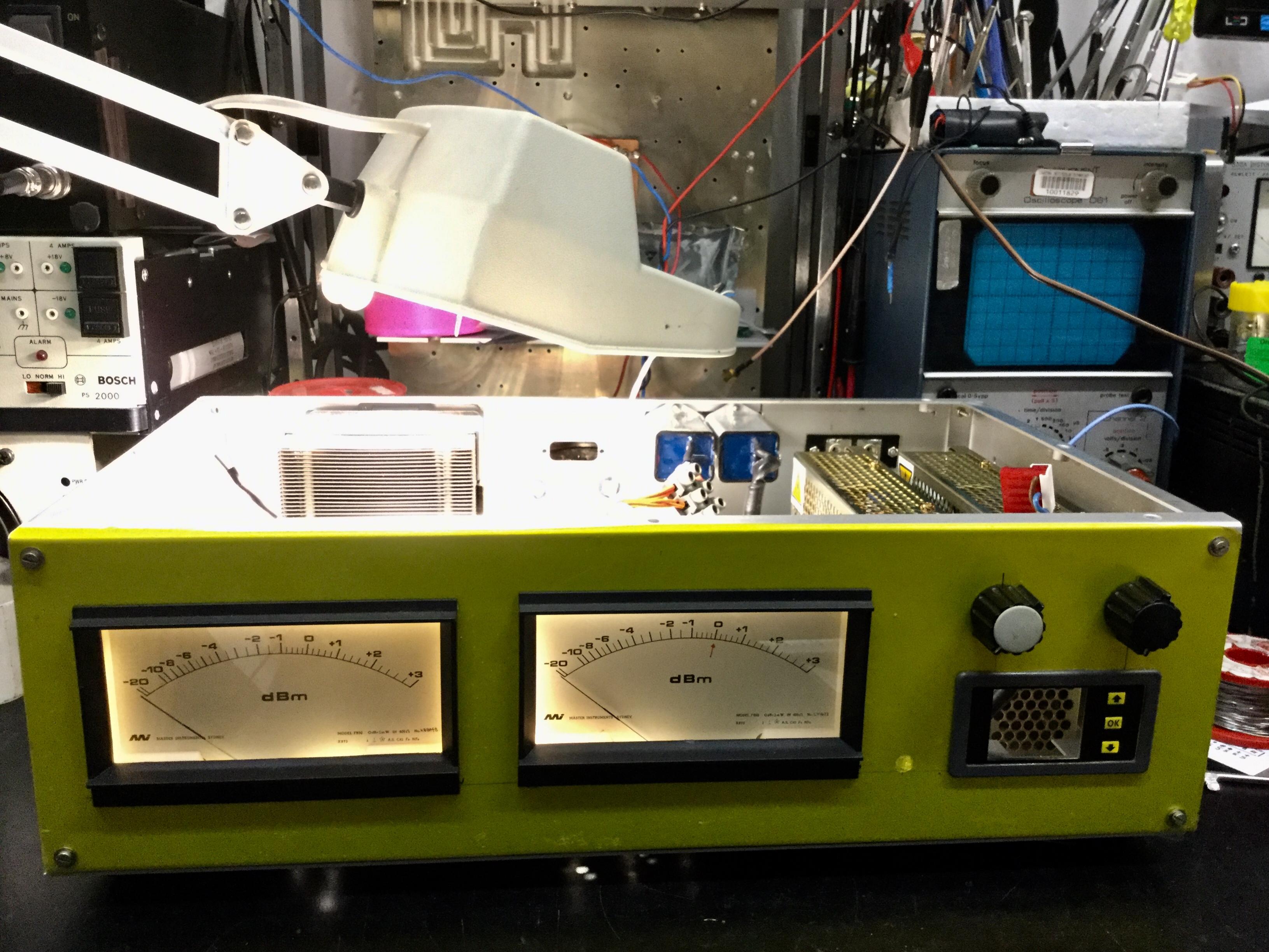

Today I work on the fascia, mounted two dB meters, a question in my mind, what is for?, perhaps “noblesse oblige”.
I think that I don’t have to go too far for the pcb, my SCB (scribed circuit board) is doing fine.
Cheers

Bi-Circleton PSU is +-22V, had purposely aiming for low cost 10mF/25V cap (Aud $0.5 ea.)
You can use +-48V to suit the transformer, B900 & 905 are within safe operating area.

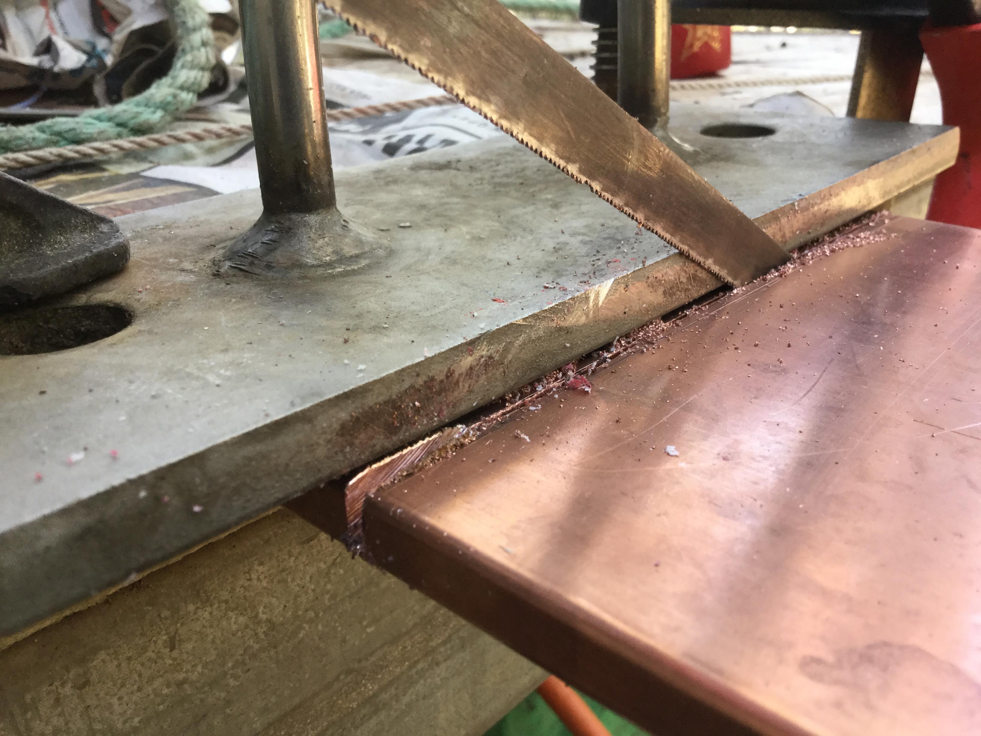

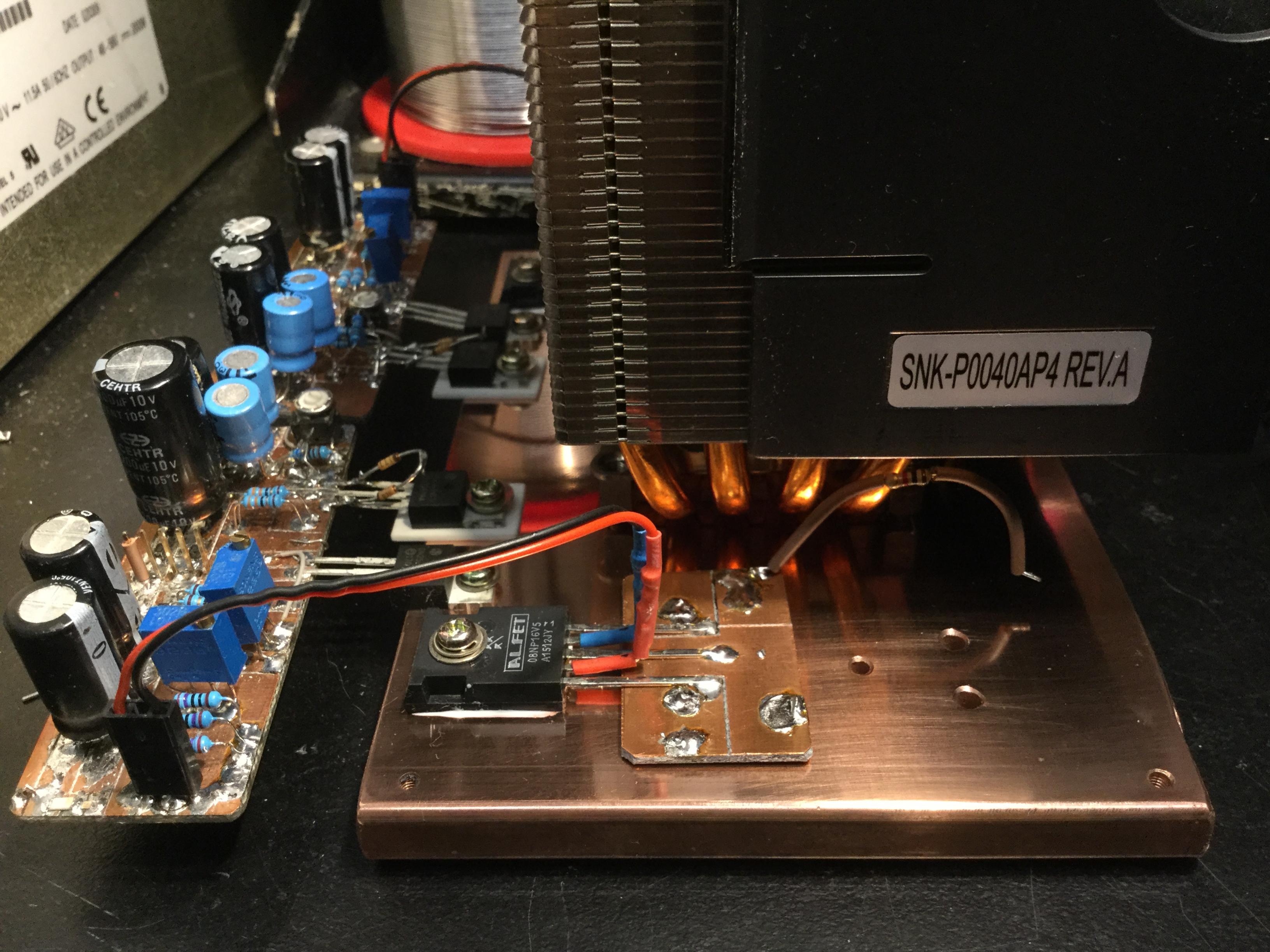

Today is labour day, means cutting the plate with hacksaw, drilling and threading holes to optimise heat dissipation revealed a few weak point from yesterday test.
Cheers and nice WE

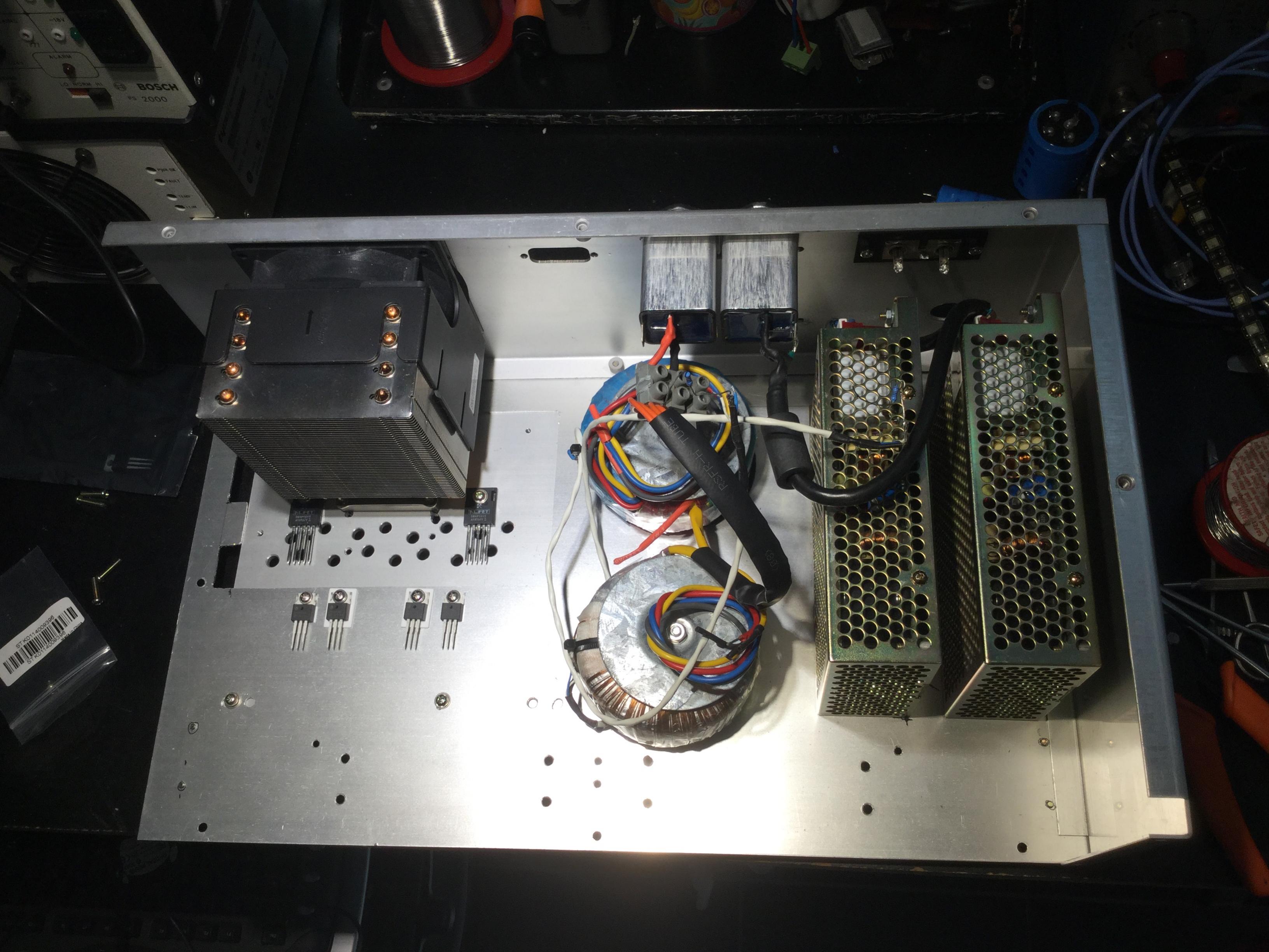

The temporary aluminium plate was replaced with copper 10mm for maximum heat transfer to the CPU fan at a very low rpm, able to sink 150W with fan spinning at 8Vdc.

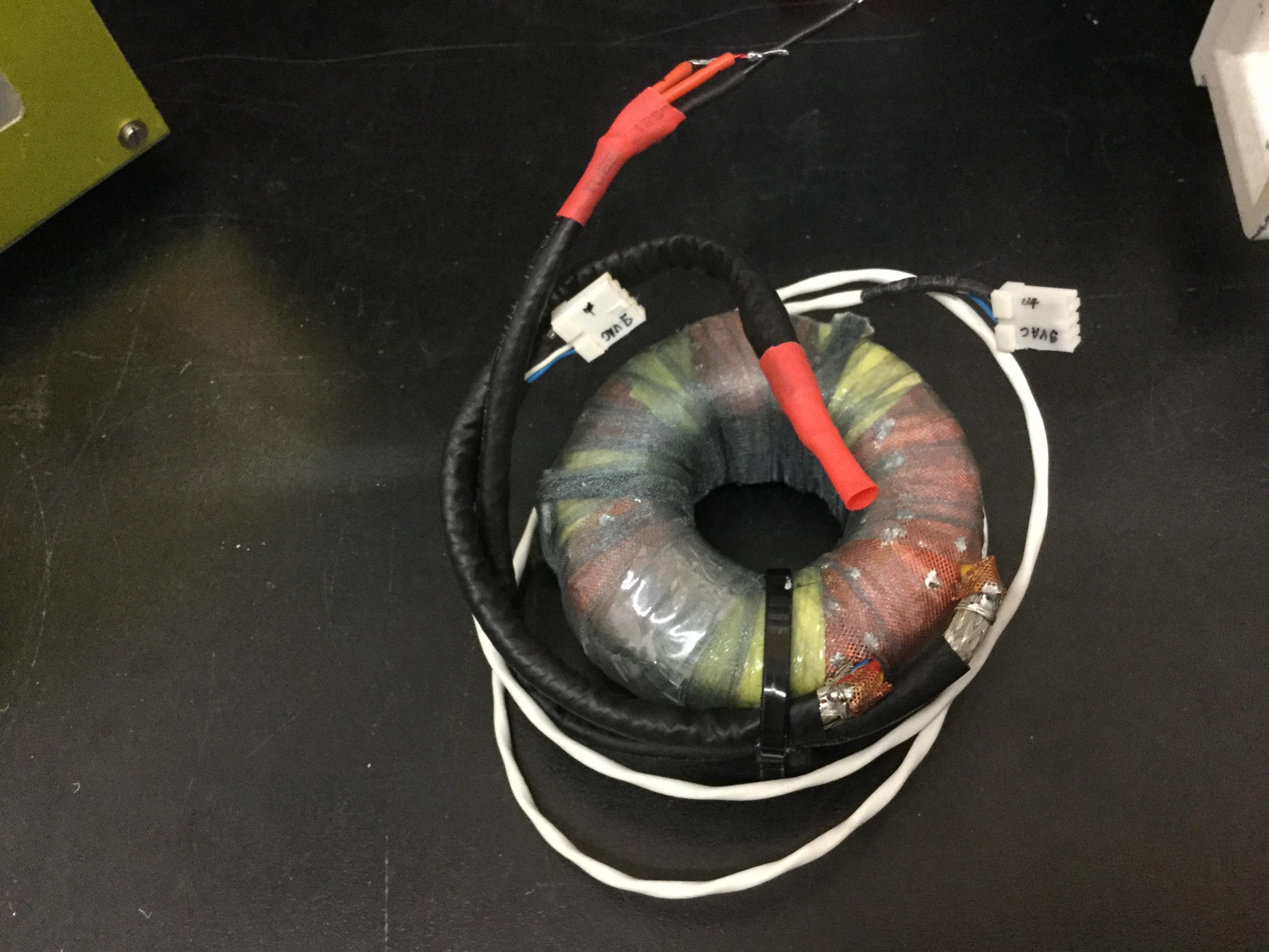

The toroidal transformer for dual 9Vac supplies also been rewound with double shields, each 9Vac lead to shield with 10k resistor beard 0.0mVac and 0.1mVac

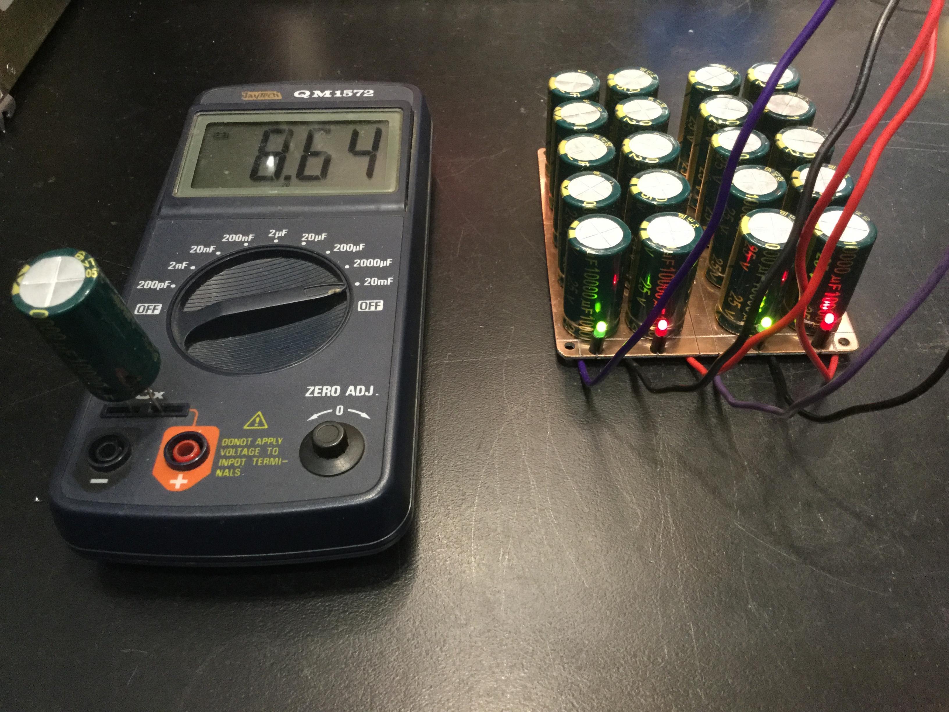

100 caps from China, 10mF/25V are delivered, well built.
Now I know why it is so cheap, a cap has only 8mF as capacitance, 2mF remaining is stated as +-20%, so they build 8mF and sell it as 10mF’s, clever people!

Today I have done the thermal test, fan spinning on 8V, sinking 140W from two channel to 49 deg C, very little noise.
