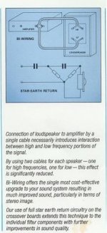

The 'star ground return' in the passive circuitry for these particular speakers prompted the curiosity (see attachment).
"Our use of full star return circuitry on the crossover boards extends this technique [bi-wiring] to the individual filter components with further improvements in sound quality."

Star earth is not relevant at loudspeaker crossovers, where wires are short and thick and frequencies are 'low'.

As for star ground return, it was in the marketing booklet supplied with the speakers. It mentions bi-wiring which I realize was largely known to have negligible effect (a gimmick in essence).
