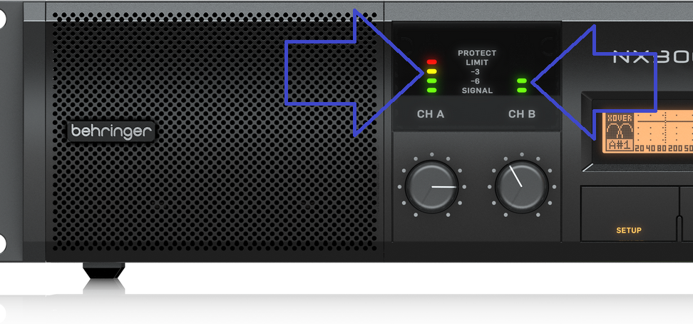

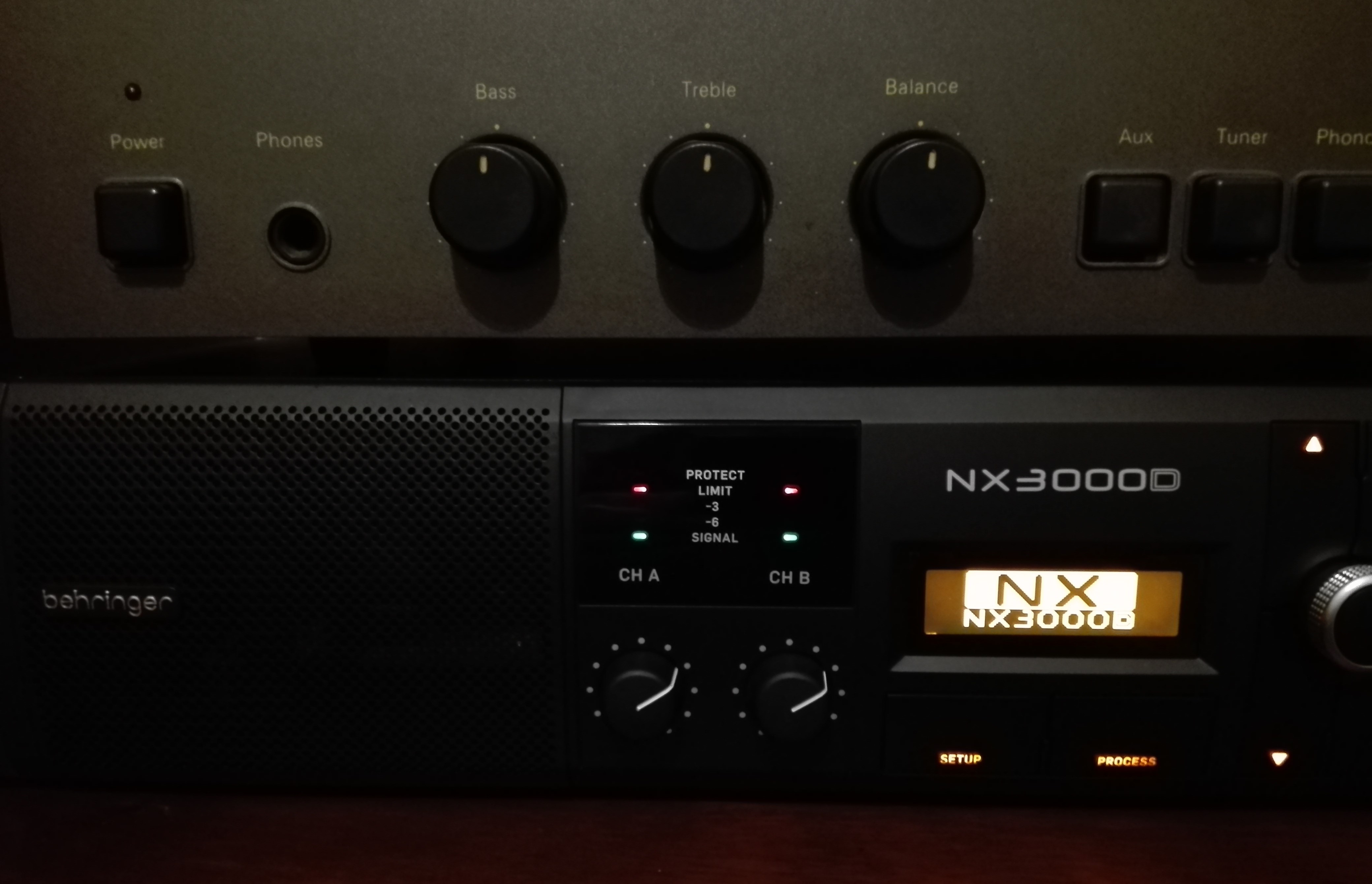

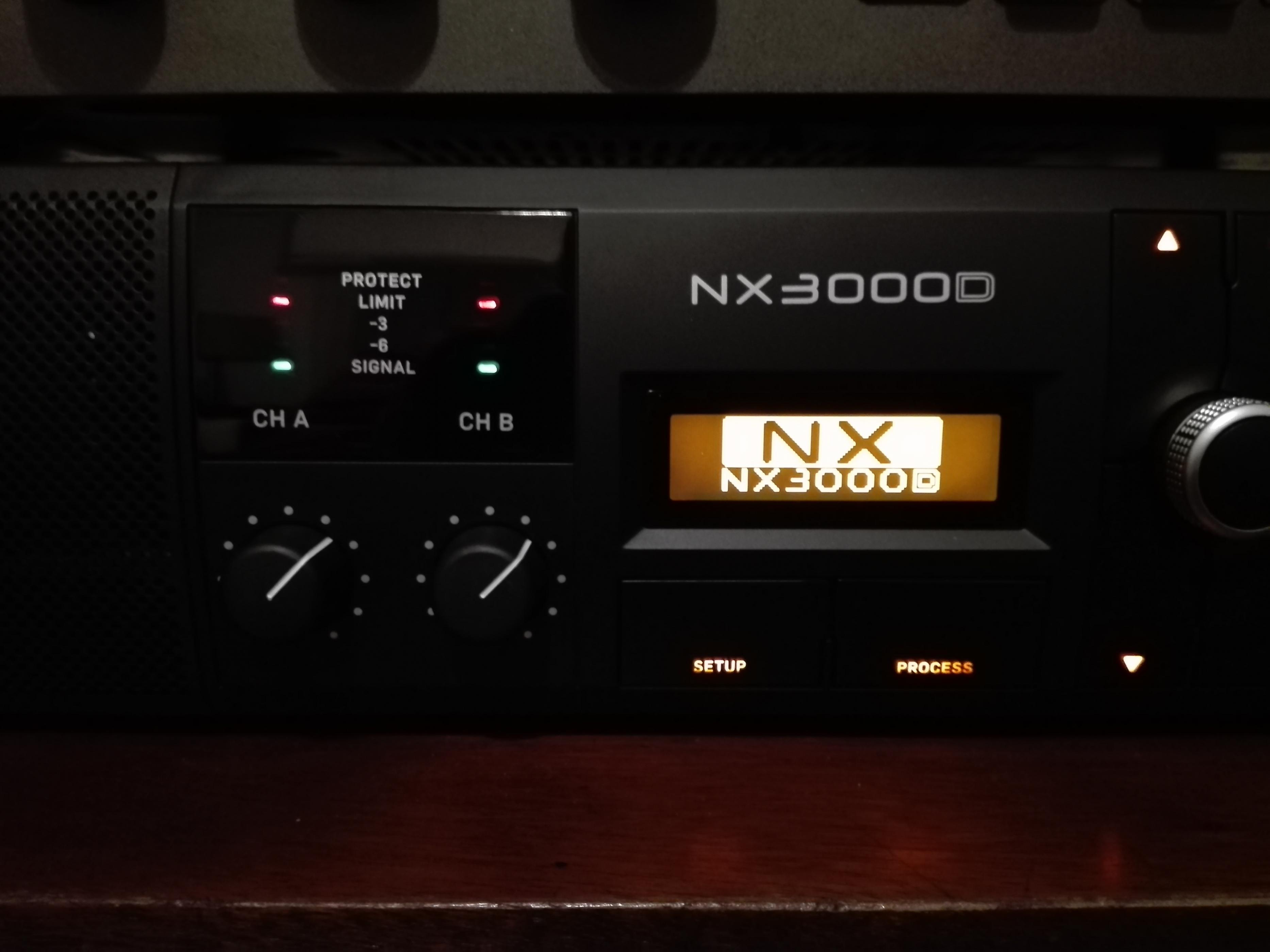

From the first time I turned it on I noticed strange behavior in the signal indicator LEDs.
Some never turn on! Check out the photos of Bheringer and my amp.
In my case, it only turns on the green light at the bottom and the red light at the top.
The intermediate lights do not act at any time, (- 6 Db green and - 3Db yellow) I have tried varying the input signal with different voltage sources, but it does not make any difference.
No matter where the knobs are located, only the lower green light will turn on, and without intermediate steps, the upper red limit light ...

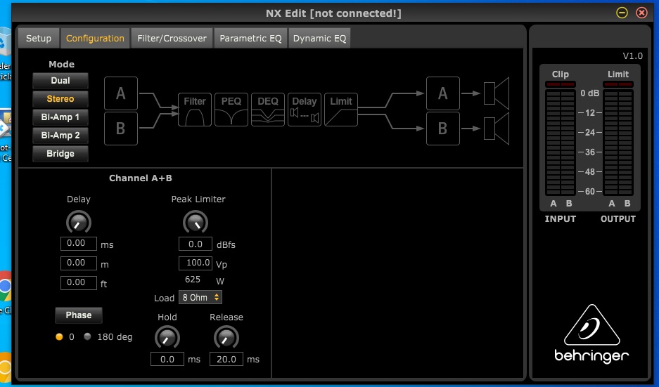

I have installed the software and have not seen any protection level selection. What there is is a power limitation, maybe you mean that, I limited the output for a 75 Watt cabinets, but I did not have a correct behavior either.

Why don't the lights in the attached photo turn on at any time (while playing music) ?
They must click on it to see the detail
If you have the amp limited to about 75w then the front panel LEDs are operating correctly. Here is why.
1500w is the rated output where the clip LED would activate.
The -3db led would activate at 750w of output.
The -6dB led at 375w.
-9db is 187.5w and -12db is 93.75w but there are no front panel LEDs for those levels or anything below that all the way down to 1w which is usually where the Signal LED is calibrated. I believe the control software has level meters with more resolution so maybe download a copy of that.

and I see that I have not been clear enough, my apologies for that.The test I did limiting the power to 75 watts was one of the last, to protect the speakers used in that last attempt, and after installing and learning about the software .... I liked how it works, it is very accurate and beautiful graphics.

Only the lower light (the selected xover in the subwoofer working range 20 Hertz onwards) and the upper red clip light came on when I very briefly turned up the volume)

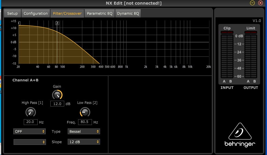

This is the software, when I dial here - 6Db and then - 3 Db, it should turn on - "with delay effect to be able to visualize quickly, Bheringer dixit" - on the amp too, right?
I'm afraid not ...... I've already been through this situation.....:mad:

Yes, when I use the software the peak indicator behaves well, and all the functions of the software work correctly.
My nx3000d flashes the - 6 nd - 3 leds if I just turn the gain knobs on the amp high enough. I'm not sure if I ever hit the limit since this is home use. Source is a DJ mixer, I guess a typical balanced drive with opamp(s) since it is cheapish product. So I think your leds are not working.

I chose Bessel on a 12db slope for a smooth transition with the satellite speakers. and I raised the gain 12 db at 20 hertz.

I did the test of leaving the "flat" configuration, without filters, and giving it volume and there yes, the yellow lights turned on (prior to cutting and / or excess temperature) and the red protection light in which it cuts the amplification and enters in protection if it was not corrected.
Of course, it was a test of a few seconds, just to get rid of the doubts I had about how the LEDs work in this amplifier .......
