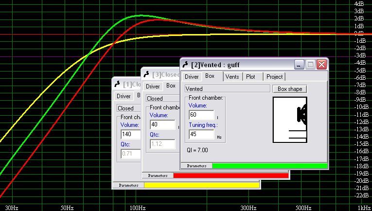

Generally speaking a 60L box is very big for a 2 x 8" driver used
for a guitar amplifier. TBH you may be better off with 8" or 10"
guitar speakers chosen for sealed or open back use.
Venting guitar speakers is pretty much a waste of time.

Graphs are for 2 drivers in a box.
