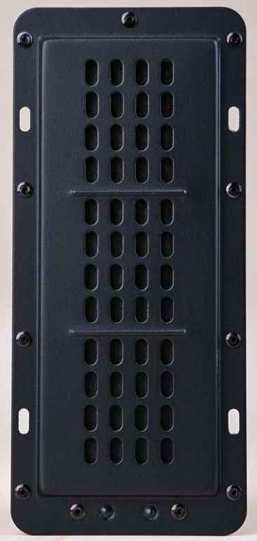

I am using neo3 pdr open backed on my speakers. However, I would like to cross them lower. So I am thinking of trying neo8s. The only problem with neo8s as tweeter is the vertical dispersion. So I am thinking of giving them a PDR treatment on the vertical axis. If you look at the picture, neo8s is pretty much like three neo3s stacked on each other. My plan is to cover upper and lower 1/3 of the driver with felt (just like neo3 PDR does horizontally. This will hopefully increase vertical dispersion with the only negative of some reduced efficiency. And then I will try to cross at around 800-1000 to a 8" cone midrange.
Has anyone tried this or something similar?
Can it work?
Is 800-1000 crossover point achievable?
And how much equalization am I going to need on the lower end of neo8s (baffleless)?

Well, there is no question; neo8s would play down to 800 naked.
My question is whether it would play down to 800 after 2/3 of its front and back surface is covered with 1-2mm thick wool felt. This is definitely going to reduce the overall efficiency and will probably damp down the rising response.
My gut feeling is that it'll cause more problems than it solves, but clearly the only sensible way to proceed is to prototype it and measure. I'm just getting to this stage with the Neo 8/ RAAL 70-10D combo I'm building for a friend. When time allows I'm going to skill up on REW some more and use my new USB mic. to measure it all. There is the possibility that the Neo 8 might sound better for you without the foam, even if the vertical off-axis response is scary. On axis at least! Try it out, that's the best thing. Have a go with different thicknesses and profiles of foam too. Although not as simple as just using the '8 all the way up, it has to be worth trying it out crossed over to the '3, maybe somewhere in the 3-4K range? Less isn't always more!
Yes, it is the same idea RAAL uses in its taller tweeters.
I am a bit sceptical about the wedge shape though.
It pretends to mimic a waveguide.
But the more important effect probably comes from covering of the radiating surface making the driver physically shorter.
So, I think a layer of pure wool felt might be a better solution.
And yes, one can try different thickness and different angles.
If placed at an angle away from centre, it would look like a waveguide anyway.

Initial experiment with compressed wool felt is promising.
I covered upper and lower 1/3 with a thin sheet of compressed wool felt.
Same on both front and back surface.
Think of an MTM: upper and lower sections of the driver are low-pass filtered physically (rather than an electrical crossover).
This theoretically will have two beneficial effects:
1. filter some of the HF output thus reduce the peak around 12kHz
2. HF comes from a 2/3 reduced radiating surface thus an increased vertical dispersion
The felt I am using is very dense. Next, I will experiment with different profiles of open cell foam to tweak the filter effect.
A small 90 degree waveguide is also in the making.
In terms of music reproduction I am not missing anything at the higher end: cymbals sound like cymbals. Perhaps there is some loss of "airiness". Once the 3 way speaker is optimized, I may add a supertweeter to see if there is any major benefit with doing so.

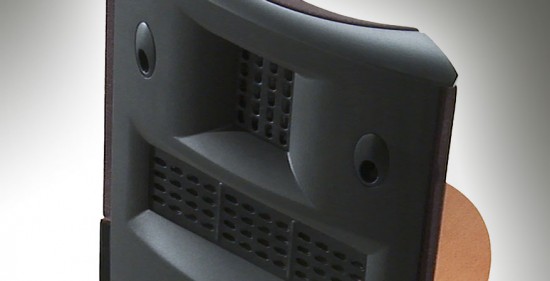

I am now building a design similar to Martin Logan Mosaic (pic).
Neo8S will be dipole and horizontally placed covering 800 to 3000-4000Hz.
HF will be taken care of by Fountek CD3.5H (this design dictates a horn tweeter).
And I will definitely try the foam wedges on Neo8S to match dispersion at higher crossover point.
