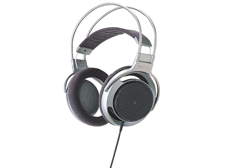

Open style headphones can be VERY sensitive to placement on the head and proximity to the ears.
I heard these Sony MDR-F1 years ago and wanted to like them, but tonality and bass response was very touchy depending on the fit to your head. Too bad, because they were very light and comfortable on the head. No pressure at all.
