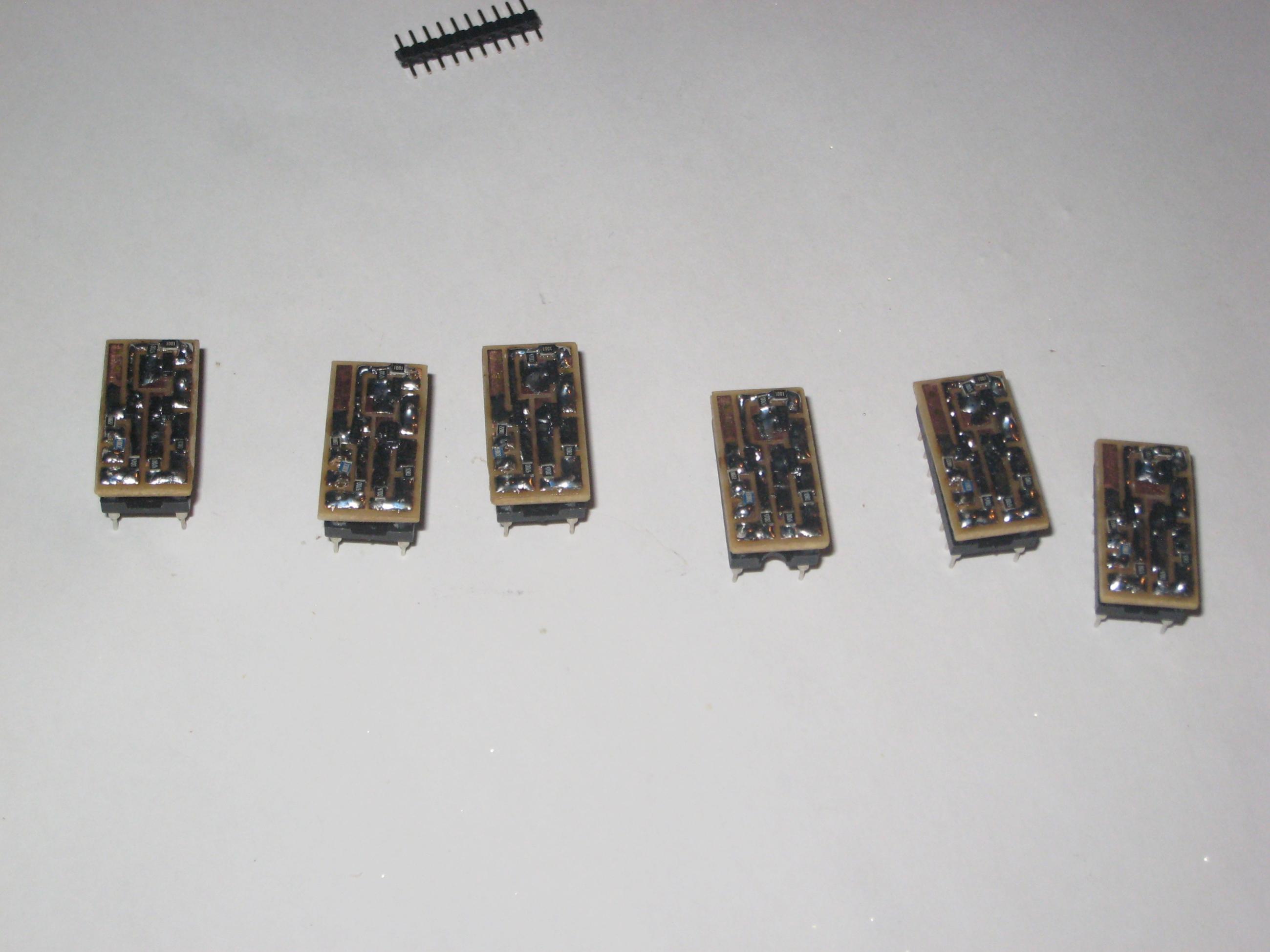

Hi Guys,
No-one responded to my post #119 about redoing the output buffer boards, so I decided to go ahead and do it anyhow... Photo attached of the six boards ready to be installed in DIP-16 sockets.
"Six?" you may ask... Don't worry, I haven't suddenly decided to tri-amp the system 😀 I only need four for Big Greenie, but making six at the same time is little more work than doing four, and I decided I'd like to have a couple of spares. This way I'm covered if any of them is duff, and if all are OK then either I build another preamp, or some lucky friend gets one...
Each of the boards contains the basic preamp circuit minus decoupling and output caps. (PSU is obviously not on it...)
Next couple of evenings I intend to pull the main board, and replace the larger output buffers, for all the reasons explained in #119. It should also allow for a much cleaner p2p layout on the bottom, which has to be a good thing...
