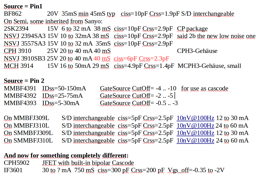

Also, it's all well and good to us P-channel JFETs, but can anyone list any good low-noise ones that are still in production?

Entering ~BF256B parameters into the On-semi selector gives BF256B and MMBF4416.
MMBF4416A is slightly cheaper and 35V instead of 30V.
I question the actual availability of the MMBF4416A since all the major distributors have 0 stock. The 2SK3557 is a lower voltage part IRRC, but it is relatively available still.

Another approach if you want future-proofed matched JFET pairs is simply to leverage the best JFET input opamps like the ADA4625-1. 3.2nV/√Hz, 4.5fA/√Hz, < 80µV offset.
Yes you've only got single-ended output, but FET input opamps aren't going away anytime soon and the matching is not going to disappoint!
