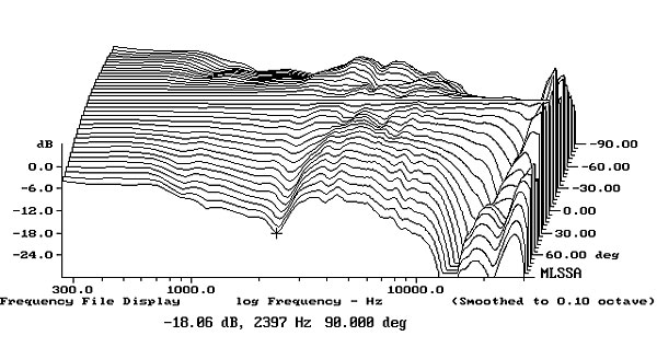

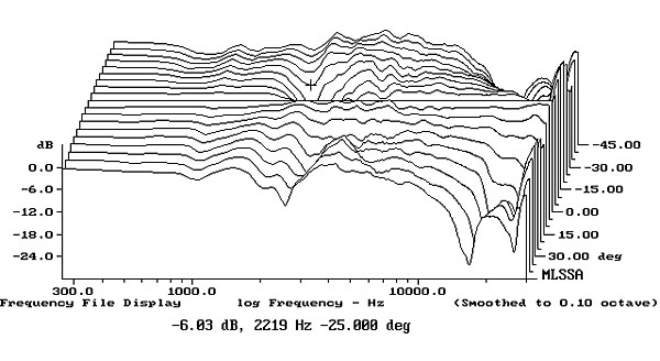

I wonder whether KEF EQ'ed the tweeter. In the raw FR, there's a 15dB drop from 2kHz-20kHz. Stereophile's measurements (below) shows the tweeter dropping off at 10kHz.
On closer examination, it seems nothing is done to tame the cone breakup of the woofer at 8kHz. So, the summed response (red trace) from 5kHz-9kHz actually contains a big portion of the cone breakup underneath (green trace).
