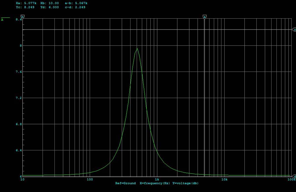

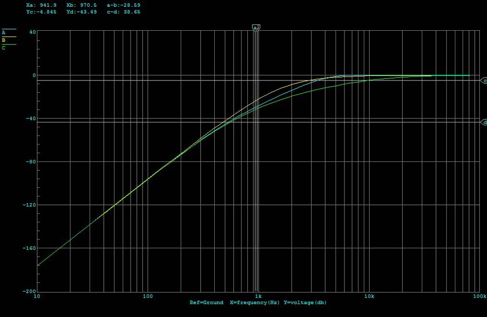

Hmm, the XO's don't sum flat. Bad news. Must be an inappropriate Q.
For a given slope, there must be an ideal Q (like 12dB/oct is .5, 24dB/oct is dual .71). What Q gives a flat response for 24dB/oct with only one filter?
There must be active XO filters using a single opamp that can do more than 12dB/octave...
