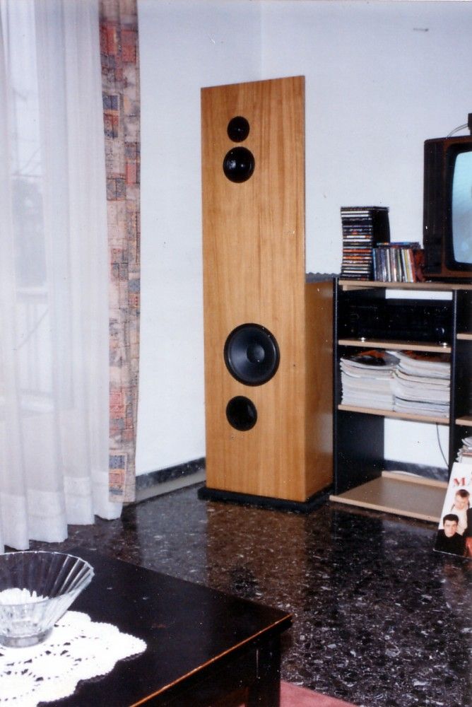

This hybrid dipole one, was made 10 years ago for a mate. It had to go near enough to the back wall. So it got dimple foam on its back and on the top off its bass box. It made a substantial difference in focus.
