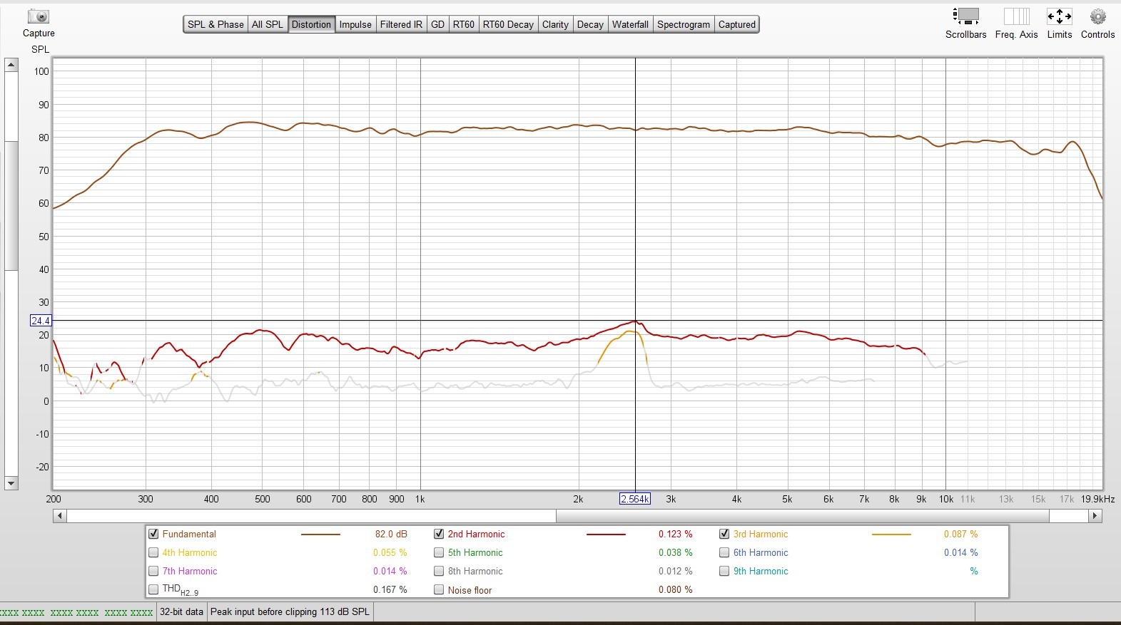

The Radian and the TD-4001 have comparably good distortion performance, the Radian driver geometry is just incompatible with the Yuichi horn.

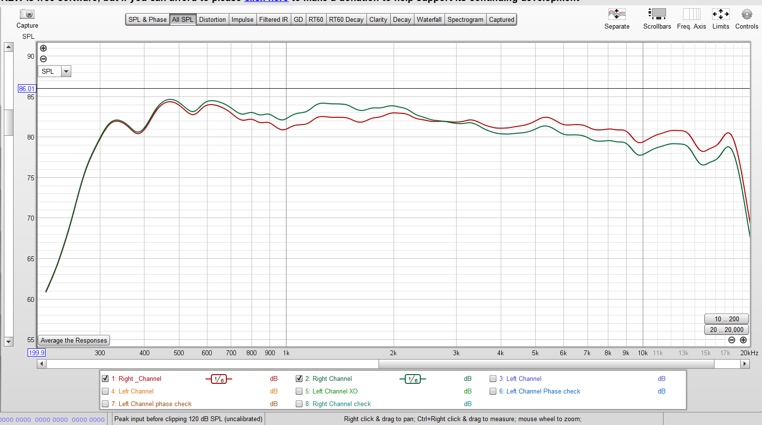

Here is an on axis (7cm away) near field response measurement of the TD-4001 on a Yuichi A-290 with (red) and without (green) EQ. The EQ I settled on by ear when measured seemed quite reasonable. EQ: DIP 1.38kHz -1.9dB Q1, HF Shelf (6dB/oct) 4.02kHz +1.8dB. Measurement range 200Hz - 22kHz
In the application am crossing at 607Hz and 7..97kHz(not shown here)
THD at 80dBspl:
I think the Athos Yuichi A-290 is a very high quality clone and would recommend it with a compatible driver. The driver I would recommend not too surprisingly would be the TAD TD-4001.
THD at 80dBspl:

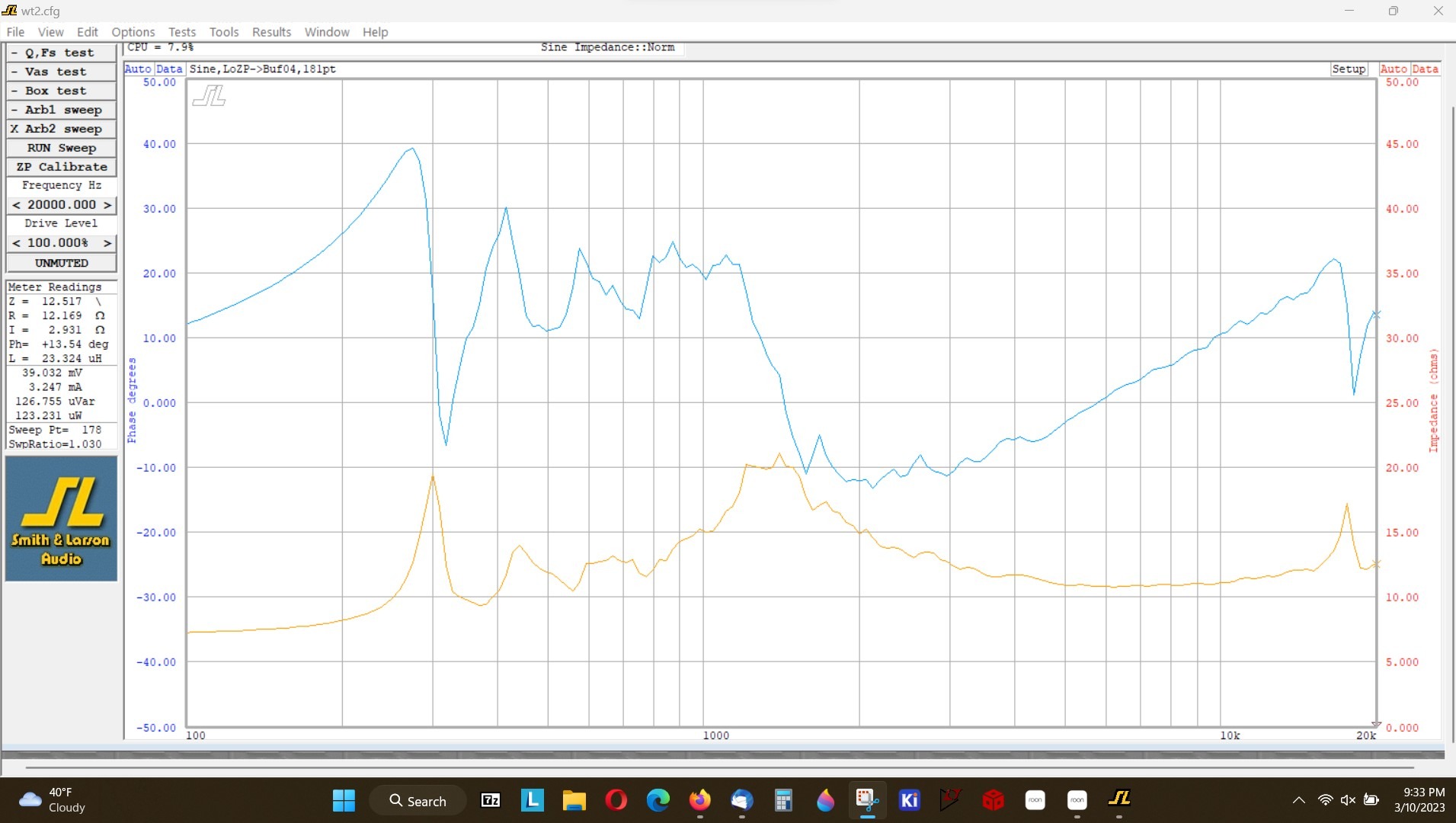

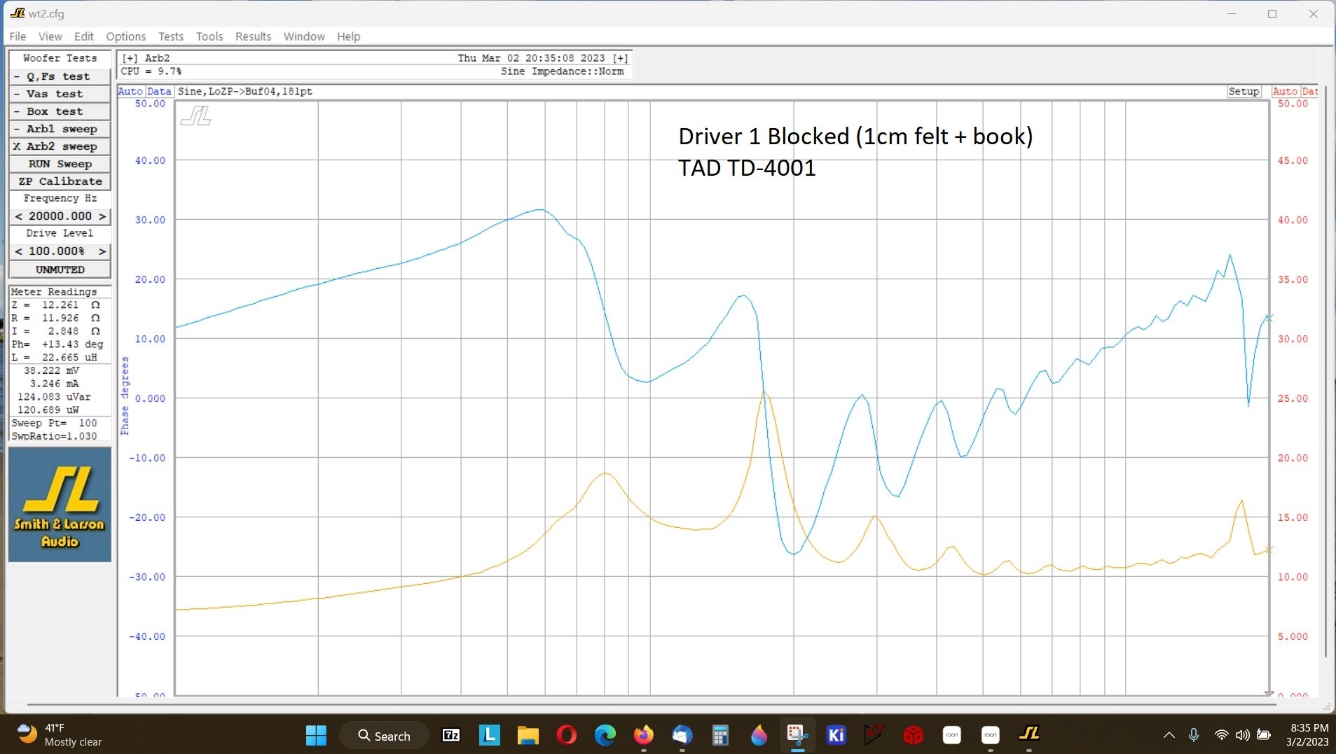

Horn loading starts right around 300 - 320Hz as predicted by Yuichi. Impedance measurement below 200Hz is ~Re. Impedance varies between 10 - 20 ohms over the pass band. Recommended operating range is => 600Hz, I cross at 607Hz. Phase shift over the operating range is ~30°
Driver # 1 on Yuichi A-290
The other driver is very similar, what appears to be break up at around 18kHz occurs at about 20kHz in the other driver otherwise they are virtually identical.
