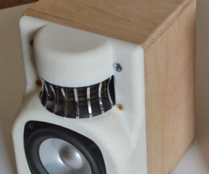

Yuichi says the A-290 is a hyperbolic horn. Attached are his design and build articles.

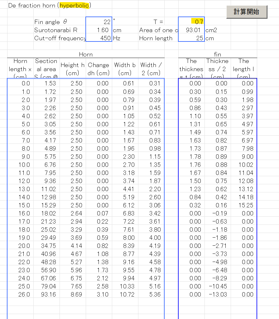

The area expansion is Hyperbolic T 0.7 for the A290 the horizontal and vertical combine to ensure the area expansion follows the design rate.If one is trying to match the expansion rate of the horn, what is it? The A290 in its horizontal axis expands at approximately 90° near its throat, transitioning to ~106° at the mouth. One might consider that to be two conical expansions, but is it really? It certainly is not exponential, hyperbolic, tractrix or other typical curved horn profile when seen from the top down.
The horizontal is quite conical which is why the directivity is more constant in that plane than other horns that load with a similar expansion.
Thanks. I will check that against my numbers and report back.The area expansion is Hyperbolic T 0.7

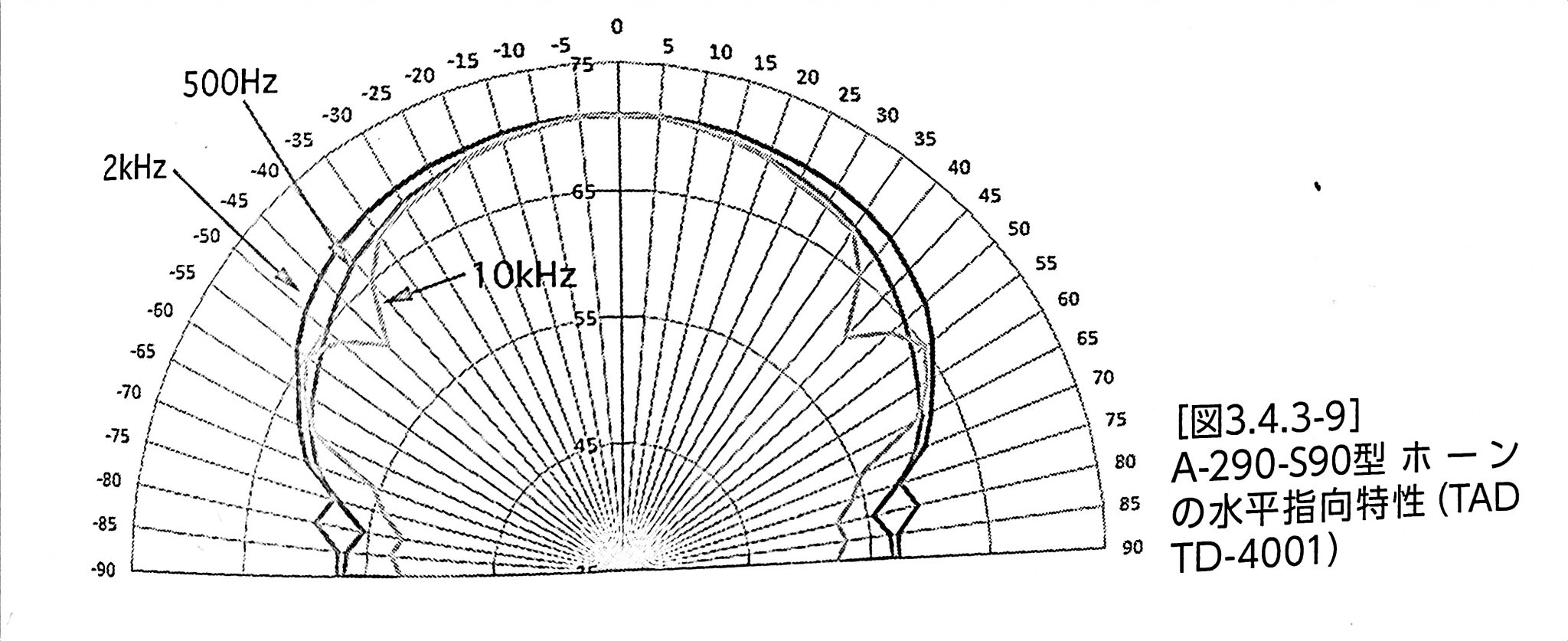

My off axis measurements seem to confitm that directivity is nearly constant over a pretty wide range. I don't have exact angles but it appears to be significantly > 80° in the horizontal plane.
The numbers work out this is an example (not A290) from a Japanese spreadsheet that @docali sent me when I was BEM modelling the A290.Thanks. I will check that against my numbers and report back.

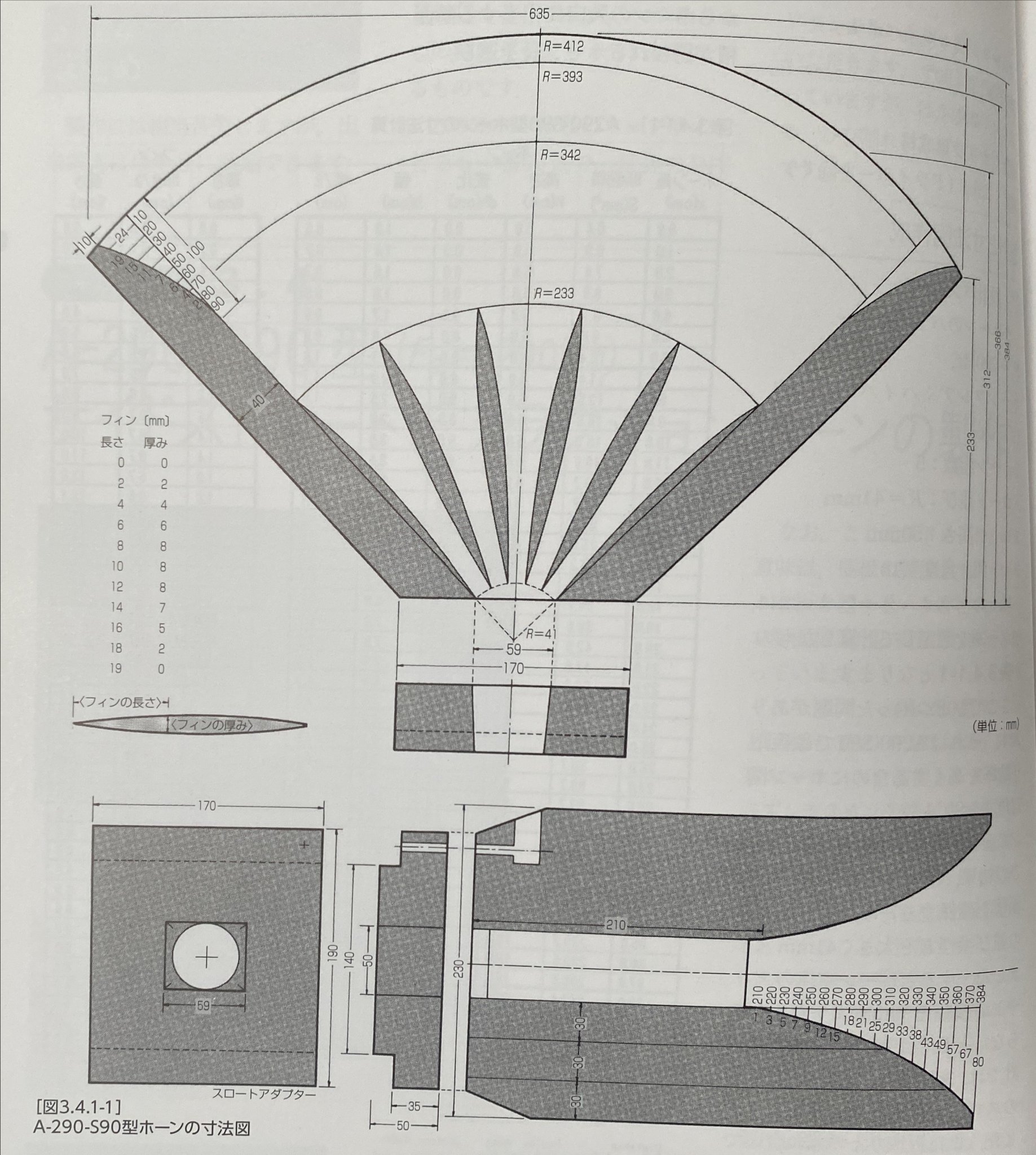

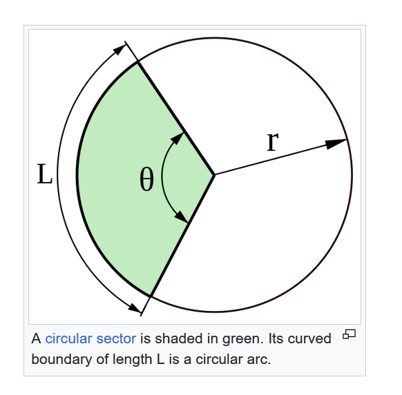

I can't get my calculations to fit. @docali How to you measure the mouth width? At the end it's a section of a circle with a radius of 40cm. It's about 106° of the circle, meaning a surface about 74cm wide.
Or should the horn width simply be a straight line from wall to wall perpendicular to the horn axis?

Based on the below diagram where L is length of arc I got 75.5cm (inside dimension, add 2cm for outside dimension) using a measuring tape. Using two rulers, double sided sticky tape and a paper protractor I measured theta ~95°. Take the angular measurement in particular with a grain of salt since there is a lot of stuff in the way
As a simplification the construction wave front is like a bended piece of paper (no bending for the vertical). and it is "s" like here:
https://en.wikipedia.org/wiki/Circular_segment
OK. Thanks.

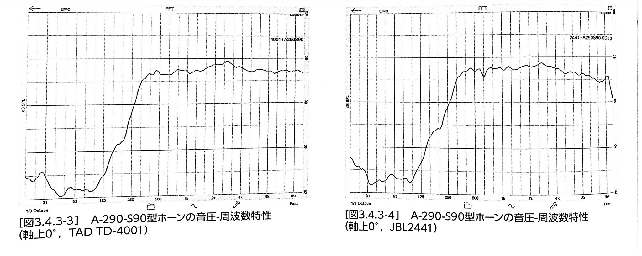

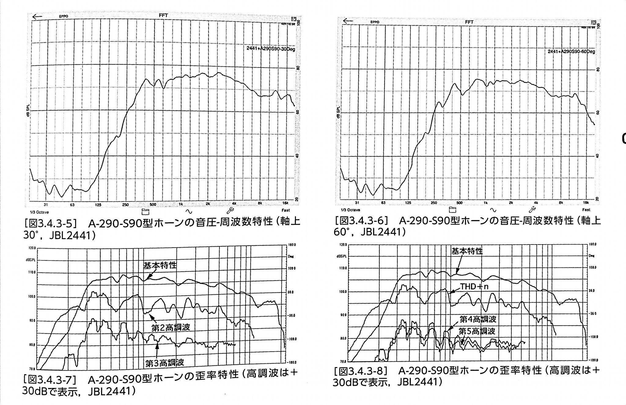

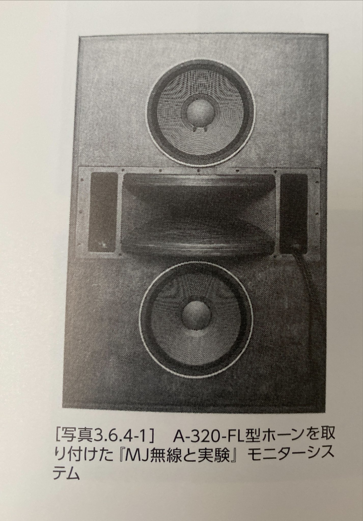

For the sake of curiosity and completeness, there is a derivative of the A290 horn called the A290-S90. Designed by Yuichi himself to make the production process easier and more efficient. It has a 90-degree opening and offers less directivity, making it better suited for use with a supertweeter. Measurements provided with JBL-2441 on and off axis vs TAD-4001 0 degrees. Specifically for baffle mounting Yuichi had a project named the A320-FL.
