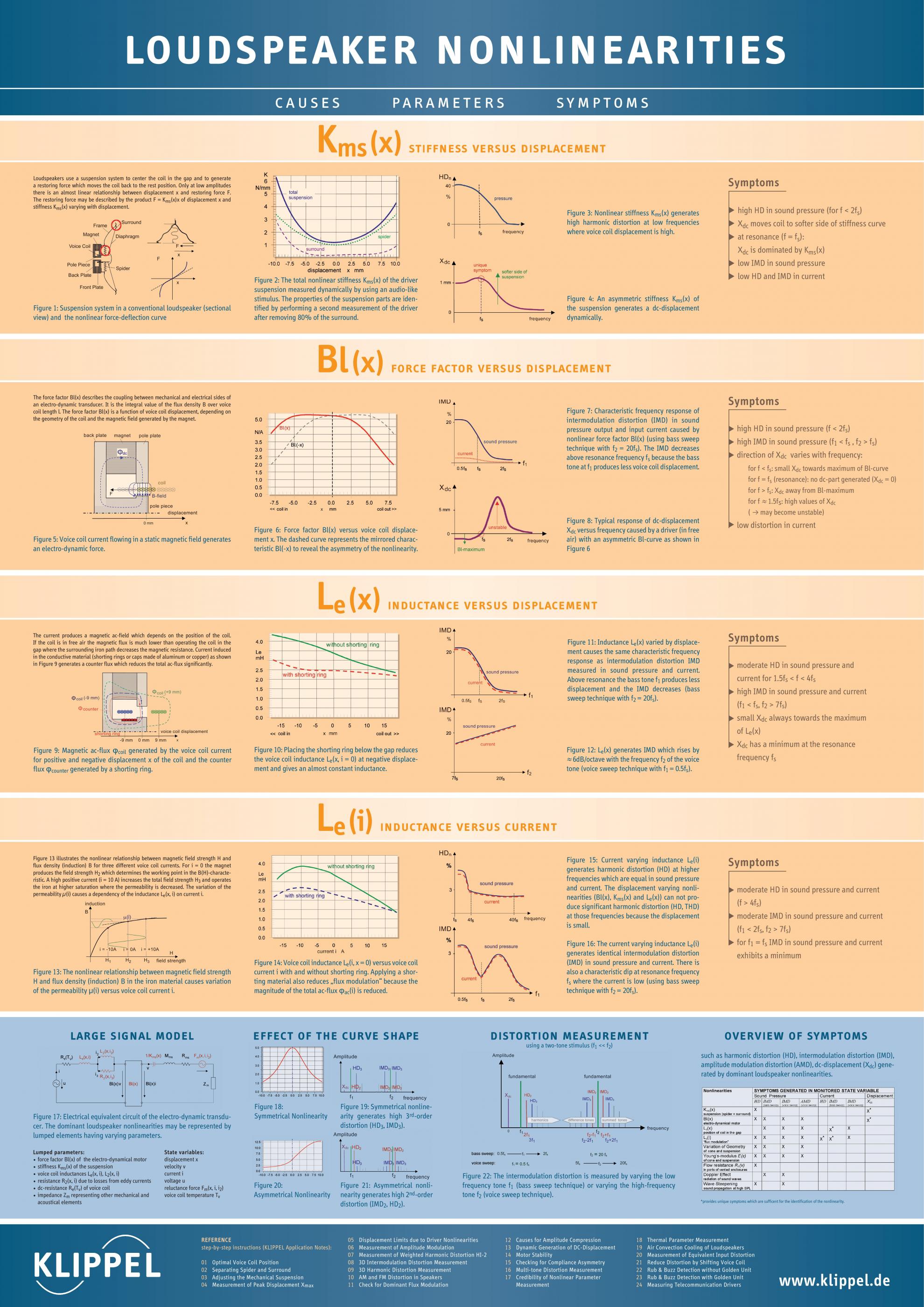

The linear mechanical parameters are always in effect, but not necessarily the nonlinear ones. It depends on the type of nonlinearity. Stiction would be a factor at low levels should I ever see it in reality, but I have not. I have seen a compliance that had a hysteresis issue where at low levels the resonance would jump up in frequency and then at higher levels would drop down, this was an extreme case, as I said before, and have never seen it since. The driver was not even for use in audio, it was an ANC driver.
A high BL does create a large EM resistance, just as you suggest. The higher the BL the less of a factor the mechanical resistance is.
I said that compliance is the major nonlinearity in any driver - that is certainly always the case. Resistance will, of course be nonlinear if the BL is nonlinear, but BL is seldom nonlinear for small amplitudes.

Since you are so nice about it, let me tell you where you will have trouble understanding. Linear does NOT mean a straight line of frequency response - its nothing that simple. It has to do with how the system reacts differently at high amplitude versus low ones.
In a transducer model the hardest thing to grasp is how the mechanical and electrical aspects couple together. They are intertwined in a highly complex way. The roles of things reverse on each side of the voice coil where large resistances in series become small resistances in parallel. This is not only complex to understand but completely non-intuitive, which is why your intuition is leading you astray.

Frequency response changes with level are very well known and documented. The vast majority of the changes come from thermal changes in the drivers. I have noted this many times here at DIY.
But we were talking about nonlinearities at low signal levels and these thermal changes do not occur there. It should be noted that thermal changes are not rightly considered "nonlinearities" as they do not happen on the signal, but on the system.

Let's not broaden the context here - we are talking about nonlinearities at very low signal levels. In that context, I would call the mechanical resistance "insignificant" rather than "irrelevant". In most drivers the magnetic resistance is many times larger than the mechanical and so even if the mechanical resistance is nonlinear - a rarity in itself - it would be swamped out by the magnetic resistance. "Mass" is irrelevant when we are talking about resistance and/or nonlinearity. Mass is never nonlinear. Compliance is the dominate mechanical nonlinearity in a driver, but that tends to be an effect only at large excursions, not small ones.
Of course, as you say, electrical damping = (BL)^2/(Re*Mms) = 2*Pi*(Fs/Qes) is always much more than mechanical damping = Rms/Mms = 2*Pi*(Fs/Qms).
BUT even so, all else being equal and for the same amount of total damping (Fs/Qts = Fs/Qes+Fs/Qms), wouldn't you always prefer a driver for which the share of total damping provided by the electric "motor" (i.e., (BL)^2/Re) is maximised and the share of damping provided by the much less ideal and more compromised mechanical resistance (Rms) is minimized?
That was the point I was trying to make earlier on.
