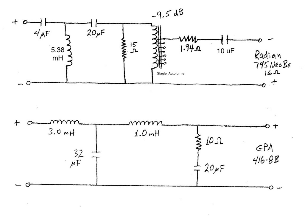

Greg¸ are your Altec midwoofers cabinets vented or sealed? And 3 cubic feet, like Gary’s, or are they larger?
Here’s Gary’s crossover attached.
Are your Slagle autoformers and inductors much different in value and/or composition, where even with the appropriate capacitor and resistor values, it couldn’t come close enough to duplicating the Fc and slope that you chose for crossing between the Radians and Altecs?
What do you like better about the Radians’ sound without EQ?
And what, if any performance aspect (s), might you have willingly sacrificed by omitting the EQ?
Was opting for no EQ partly based on your amplifier choice? Might you have chose to use it if your amp were 300B SETs monos? Perhaps as good or better designed than these? Coincident Speaker Technology Frankenstein II Tube Monoblock Amplifier | The Absolute Sound
