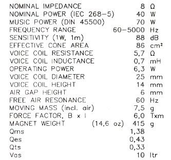

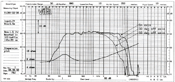

The Vifa 13WH is kinda irreplaceable. Why was it discontinued? You have to suspect a Global Conspiracy.
Enjoy one of the greatest vented bass drivers ever made. And now discontinued. 😀

Be interesting to hear it - there's a bit of a scary wiggle at about 1k2Hz, visible in all three plots. And what looks like cone breakup at around 3K - right in the cross over region. The P13 has some wiggles round there abouts (at least when driven to 130db - see Linkwitz) so it may not be all bad. Roll out the pink noise test...
