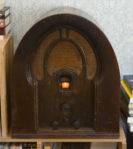

Enjoyable sound - Philco 91
In my last post, I promised some examples of unconventional (at least by "high-end" standards) sound reproduction example that nevertheless are quite satisfying. Here is an example given to me by a co-worker over 30 years ago who found it in his grandparent's attic in Kansas. It is a Philco model 91 "Baby Grand" cathedral radio, first produced in 1932:
This was their high-end model, and has nine tubes. The audio power amplifier is push-pull type 42 pentodes (same as the 6F6), driven through a transformer by a single type 37 low-mu triode. The speaker is about 7" in diameter and is electro-dynamic. Other than having some capacitors and tubes replaced, it is completely original. Although this style of radio was called a "midget", it is rather large: 16" wide, 11" deep, and 18 1/2 inches tall.
Why include this example on Lynn's "Beyond the Ariel" thread? Well, technically, it does use a push-pull amplifier with no feedback and a modified open-baffle cabinet. However, I prize it for its unique sound - a bit boomy, but otherwise rich and warm. It makes music and voices sound really appealing - in fact it is a sound that would be impossible to buy in new equipment today.
There is not much interesting on AM radio today: mainly religious stations, hate radio, and country music (not my style). However there is a station I can get that plays "oldies" including some going back to the '30s and '40s. It is these vintage songs that really work well with the sonics of this radio. The sound reproduction systems of that era really took advantage of the technology of the time: crooners singing into ribbon microphones, and 78 rpm records that matched the limited high-frequency capability of AM radio of the time (5 to 8KHz). Despite these limitations, the experience is really enjoyable. Contrast this to the radio in my new car, when listening to regular AM radio stations, has a severe HF cutoff (it sounds like 3-4KHz), or, if in range, AM HD radio that has wide bandwidth, but obvious digital artifacts - quite unpleasant.
Lynn's new system will undoubtedly go far beyond what this table radio can do. But I'm sure there is a little bit of this radio in it - the part that makes the experience enjoyable.
