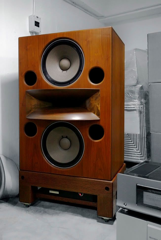

The adequacy of a single 15" driver has a lot to with room size. My listening room is nearly twice the size as Gary Dahl's, and is open to the whole first floor of the house. In typical American style, the house is "stick-built" with wood framing, so the lowest frequencies (below 40 Hz) are partially lost due to wall flexing and large window areas.
In the earliest Dallas prototype, there was an occasional impression of the compression driver having more dynamic range than the 15" woofer. Oddly enough, the Altec 416-Alnico had more apparent dynamic range the JBL 2226. Maybe the 2226 just needed more power - it's intended for movie theaters and sound reinforcement use, after all.
The obvious solution was to curtail the dynamic range of the compression driver by stepping down to a 1" exit driver, but I didn't want to do that.
The few times I've auditioned systems with a pair of 15" drivers the apparent dynamic range is much greater, as you would expect with a 6 dB increase in headroom and power-handling (3 dB from doubling-up voice-coils and another 3 dB from efficiency gain). The biggest downside is doubled size, although that's still not as large as a LF horn.
If the builder has the space, the Inlow Sound 135 Hz bass horn is an attractive solution, with the most dynamic range of all. But I don't have the room, don't want to mess with time-alignment through DSP processing, and don't want a folded horn (which has its own set of problems). So a pair of 15" drivers looks like the most practical solution at this time.

The Ariel replacement involves indirect diaphragm that is a little less able to comfortably shift very small increments, but it will do it but not quite as easily as a direct dome tweeter.
